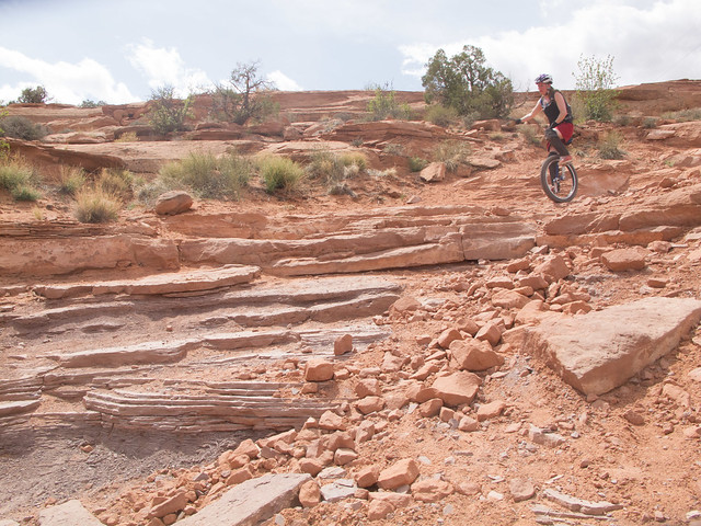

The 29 is fine on Slickrock, if you’re going to walk the uphills, which most people do anyway. Tomas rode a 36" this year and enjoyed it. But on Porcupine Rim and the other super-techy trails, you’d have to skip the fun parts on a bigger wheel, unless you like doing super-techy stuff on a big wheel.
You don’t want a 29er on this:
