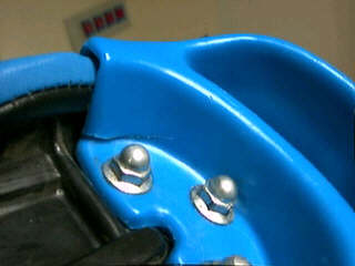

I’ve noticed in all the unicycling videos and photos that I’ve collected, that so many people ride with Miyata saddles. At the same time, I keep hearing people talking about how weak they are and how the lift handle cracks. If these problems do exist, why do so many people still use the brand? Are they real problems or are people just exaggerating?
I was also wondering what part of the lift handle actually breaks. Does anyone have a photo of a broken one?

The Miyata is a good seat. Or rather, was a good seat… it seems more recent ones have had handles made of poorer materials, so they crack lots. Both of mine have cracks; I’ve tried to get used to holding them differently so they don’t crack, but I’m just holding out for something better.
Yoopers has a good idea on this one, but I’ve never plucked up the courage to drill a hole through mine… Frankenyata I think it was called…

They are great!!!..untile the crack. :angry:
I have 4 miyata seats that are cracked…errg.
But i just leave them on and keep on hopping, the only thing is they bend so I cant get as high, and so far they havn’t fallen off yet, heh. So many people use miyata because there there is no perfect seat yet made, and the miyata is very good for the lift handle comfort…unitil they crack! :angry:

Thanks phil, that’s exactly the type of picture I was looking for. Is a crack like that caused by the saddle hitting the ground or is it caused by pulling up too hard on the handle? If I’m getting a Miyata saddle should I expect it to crack?

Yes, excessive hopping makes them crack :angry:

Andrew,
You can see a picture of our fix for our cracked Miyata seat handle at http://photos.yahoo.com/yoopers98 Click on the “Miyata” folder.
Bruce

That’s a really good idea and the puicture helped a lot. Do you have to be careful where you drill those holes? Thanks for the suggestion.

Yes, I would take your time and definitely employ the ol’ carpenter’s rule of thumb, measure twice, cut once. It’ll be important to ensure the hole is properly located to allow some material to remain above the hole (as the saddle sits upside down). If not, then the fix is obviously no good.
Matter of fact, after thinking about it, I would even recommend drilling the holes without the cover in place so you can see exactly where the drill bit is going to hit the saddle base. You can always punch through the vinyl cover later.
Our fixed Miyata saddle continues to do well. We’ll report back to the group if we experience problems.
