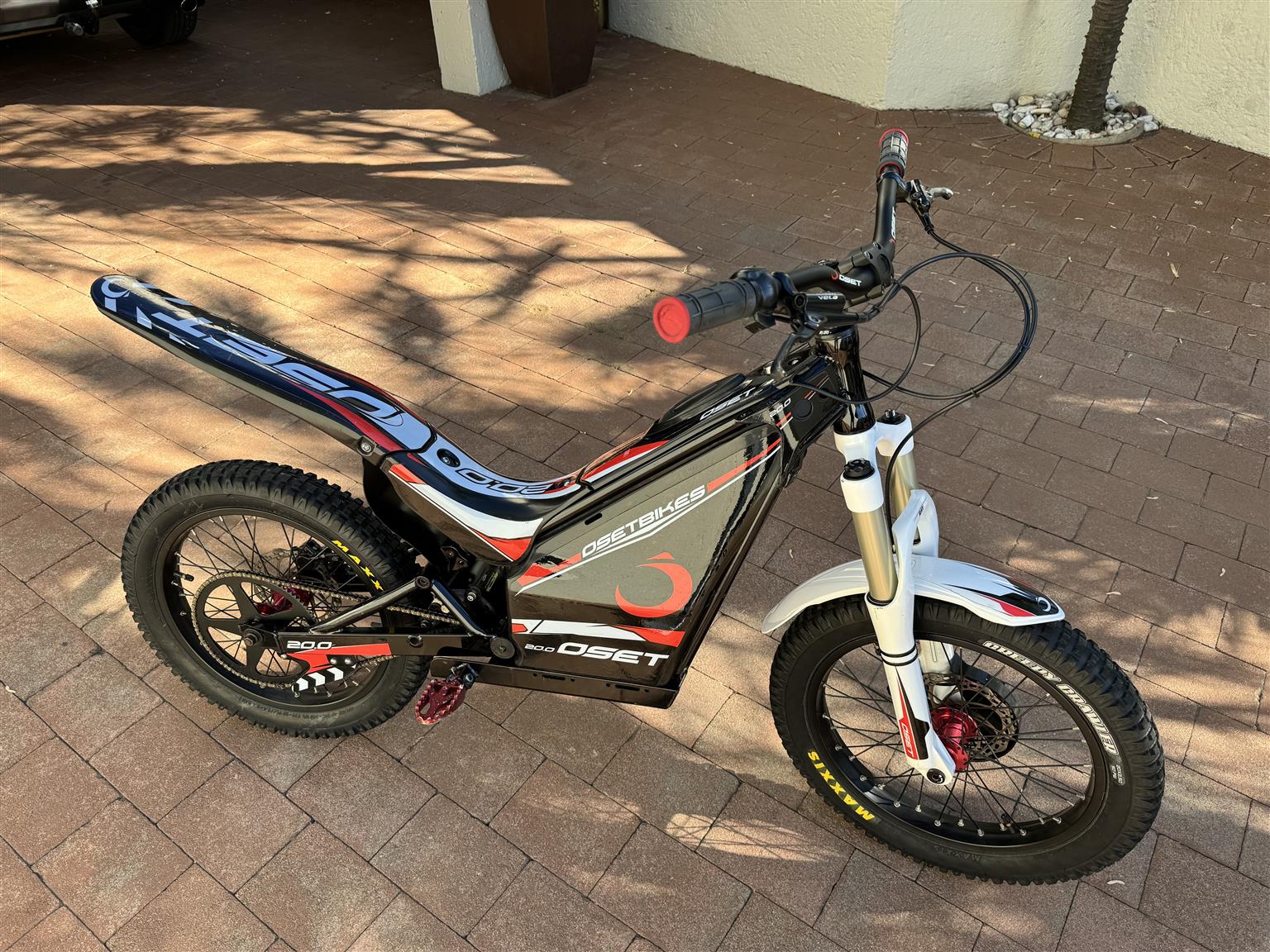

Anyone know that an OSET 20 (electric Trials bike) uses same tire as a 19" KH UNI ?

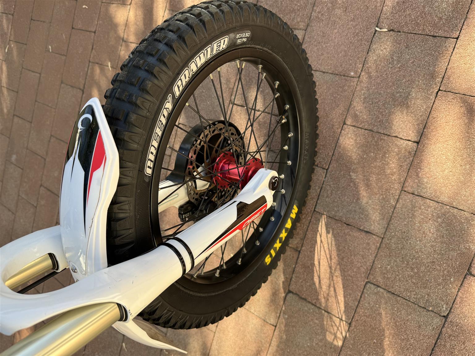

It got me wondering if the rims and hubs are also compatable ?
The hub won’t be compatible. It’s a through axle hub so fitting it to a unicycle would require welding an axle in (assuming it fitted). Maybe if you were making a giraffe or jackshaft drive uni you could fit the hub and replace the brake rotor with a sprocket.
Rim wise, it looks like a 36h rim. Assuming spokes are the same thickness (or within ballpark) this would work on a uni.
The rim would probably be a rather heavy option so i’m not sure why you’d choose it over the options that are available unless you just had one fall in your lap for free
