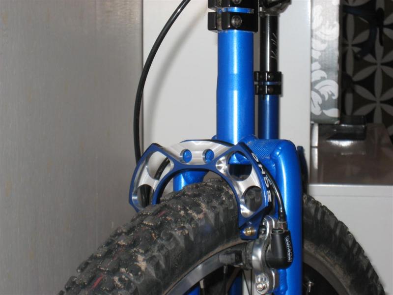

From just goofing around in my apartment it seems that:
- Frame flex almost nonexistent (<1mm, can’t see any) now (before it flexed about 3mm on each side if I squeezed the lever firmly). So whilst the KH is stiff the Maguras put lots of stress on any frame (even 2wheel trials frames use boosters and they are designed for a sport in which you really need a lot of braking power…) You really hear the distintive clunk now when the pads contact the rim and the the lever will not budge any more.
I expect the feel to have improved and the noise to have gotten more dull, as this is what happens on trials bikes. - The horrible squealing has subsided, but I’ll not assume it’s gone until the pads are worn in to then new adjustment…
- Sanding the rim seems to have made the biggest improvement, but since I did all at once I can’t verify this.
I’ll report back once I’ve gone for a proper ride. I’ll try and post a pic also, the booster looks really nice on! ![]()

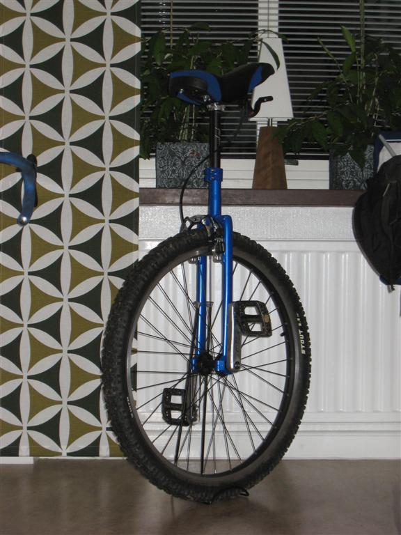

Update with pics. Haven’t ridden anything this week due to constant raining, but hopefully will ride a bit during the weekend.
Wow, that looks like a beast of a brake. Do you know how much the booster weights?
52g according to the manufacturer (without bolts). This is one of the lightest boosters on the market (possibly even the lightest stock?). I would say weight is not an issue though, I was mostly curious to test a superlight 2bolt booster, having used what is probably the buffest 4bolt booster on the market on my trials bike way back when…
Anyway it seems to do the job good enough. (I’ll “field test” it properly today.) The main caveat is the price, is cost me more that half of what the hs33’s cost me.

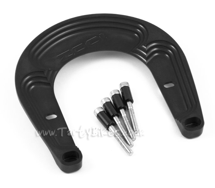

This is probably a better option in reality:
Same high price tag though.
I guess for half the money this one would be my recommendation, it’s thrice the weight though (but that won’t matter) . ![]()
