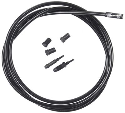

And here is the promised pic :smiley:
The left part is the broken fitting disassembled from the line.
The right part is the un-removable fitting that usually fit the lever.
