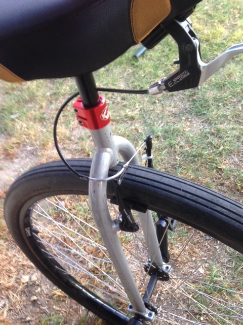

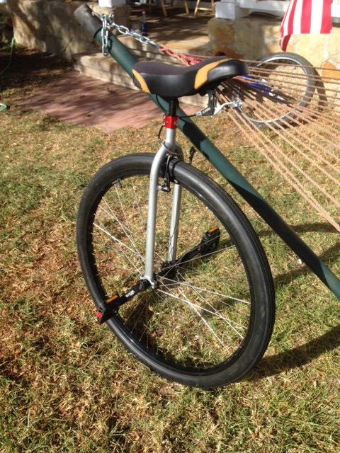

All done! This is at the lowest point. I loved the suggestion about measuring another one of my uni’s with 150mm cranks. I adjusted that uni to the preferred height on average muni conditions, and then measured it out. Chopped the 36er post to match. Easy peasy! Way too much extra brake cable, gotta learn how to shorten it. This baby needs one of Danes special paint jobs.
There is probably enough spare outer on that to fit up the front wheel on a b*ke.
try to keep the cable as short as possible without putting it through anything more than gentle bends.
Yeah, I know nothing about brakes. But it’s about time I learn. Watching some instructional youtube videos.
Sheldon Brown’s site has some excellent info on brakes, as well as cable routing.
The trick with cable brakes is to manage the friction on the cable. With the exception of the actual brake setup (pad alignment, spring tension adjustment…) almost all of the tips and tricks to make them work better have to do with friction. So: a shorter housing, lubing the cable, filing/grinding the end of the housing to remove burr’s left by the cable cutter, reaming the liner at both ends, using ferrules that prevent moisture getting into the line. All of this is to make the cable move better.
On a uni, it can sometimes be beneficial to de-tune the brake. This can give better speed modulation, and minimize the chances of locking the wheel. So, in the end a longer cable may not be so bad. I would still clean the end of the housing, and ream the liner, but as long as you don’t rub the cable as you ride it may be alright.
Well too late I already did it!
Don’t cut brakes
I used to think the brake lines should be cut to the exact length needed. After all, these are high end uni’s, right?
Now my thinking is to leave the brake line alone and just wrap it around the seat post.
Right now your uni is setup for 150mm cranks. The day will probably come where you want to try 135mm; then 125mm; then 110mm; then 100 (maybe); then 89 (ok, that’s sick).
The point is every time you shorten your cranks you need to raise the seat height, which increases the demand for brake line length. At some point a precisely cut brake line for the 150mm cranks will either be too taut or even too short. At that point you’ll find yourself doing creative engineering like moving the brake lever closer to the seat post, re-routing the cable, etc.
Yep, I learned this one the hard way…
Problem is, when your line is too long on a cable brake, it can make it so they don’t work properly.
I have a brake set up on my 36er, and temporarily had to move it further in by my handle. I had a lot of excess cable and wrapped it around my post. The result was a brake that wouldn’t work at all, one side would constantly rub.
I think Dane has plenty of line there to adjust crank length or seat height. And if not, cable is really not expensive at all.
It’s true, and I have seem plenty of brakes that lost everything to friction in the line. In this case since Dane didn’t say it wasn’t working I assumed that it was working, just long. But you are right that to get the most effective braking you want the shortest line possible.
Personally I believe that it’s better to run as much of the cable outside of housing as possible. I know that there is a current trend towards full length housing, but I think it’s more of a compromise on the part of the manufacturers. This way they don’t have to have separate guides for cable vs. hydro brakes, and they can use a single frame on a few different models without modification.
