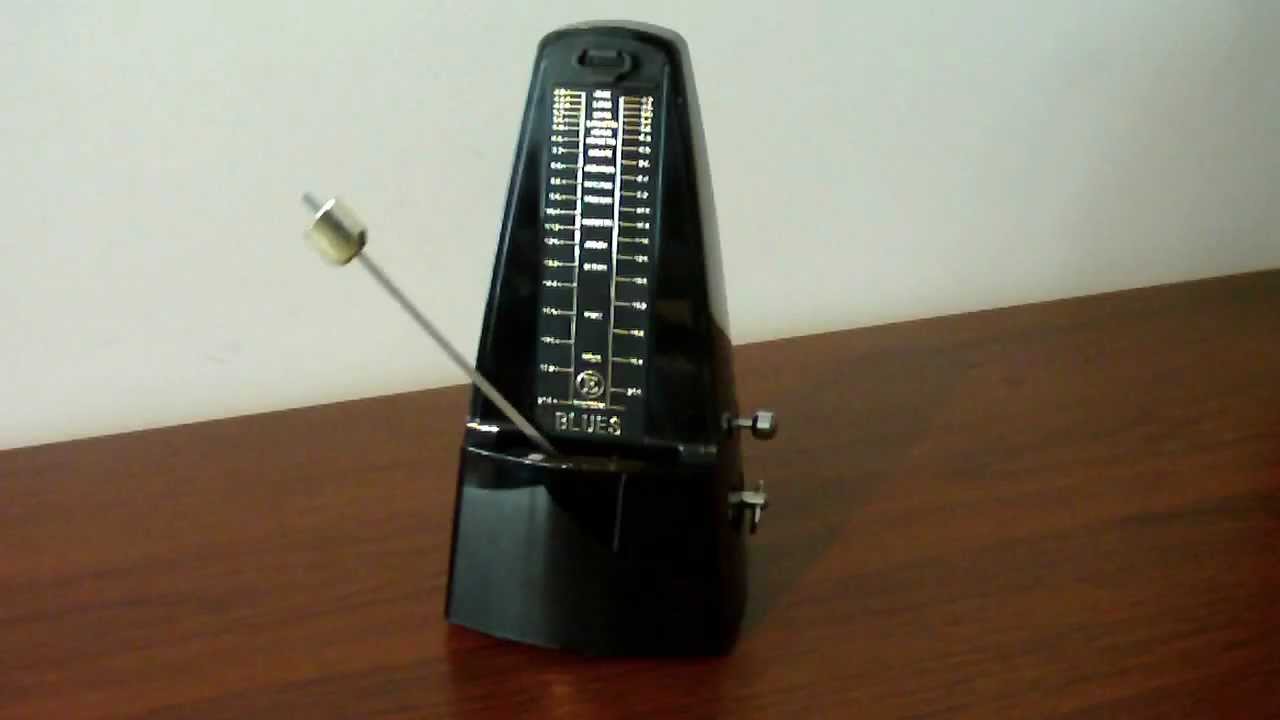

A unicycle is similar to a pendulum, but the other way up — a bit like the moving arm on a metronome. Slide the metronome weight up the arm and the arm moves more slowly. Slide it down near to the pivot and it moves more quickly. An inexperienced unicyclist will react more slowly and more clumsily, and therefore they need things to go wrong more slowly. Sitting tall in the saddle is the equivalent of moving the weight on the metronome up the arm.
