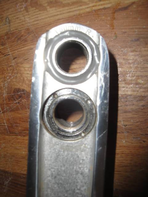

Just to clarify, could you be referring to retaining ring? If not, did you somehow strip the actual pedal thread? Just wondering, because I as well as many people have lost a retaining ring or two from moment cranks every now and then. I got a couple replacement retainers from udc, but only one would thread on, while the other would not go on more than 1 turn. So I found an alternate method for assuring the thread inserts would never come out or get loose; Epoxy! :smiley:

I’ve lost several retainer rings over the years–most fell out when the cranks were only days or weeks old. They were dual hole cranks only, and the lost retainers only came out of the longer crank hole, not shorter. I received replacement retainers, but they would not thread on properly, or fully. So I used JB weld epoxy, dribbled it into the open channel where the ring would normally go, and it is now rock-solid and the inserts will likely NEVER come loose or start spinning freely. Next case! :smiley:
