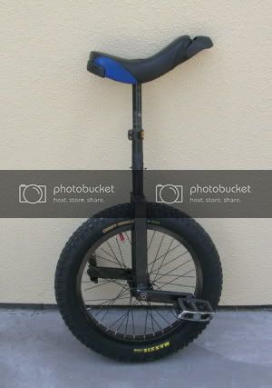

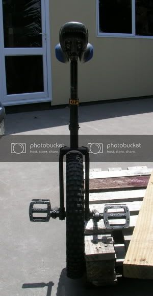

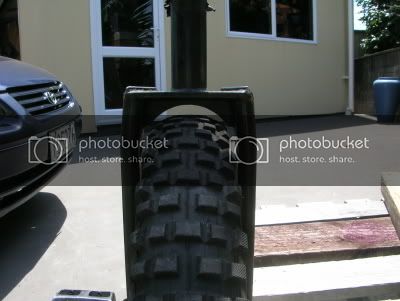

Here are some pics for you Sponge:
yes then, a koxx/kh clamp will fit, as the ID of the clamp is 31.8mm which I assume is the true OD of the seat tube. Have fun and get your seat clamp as soon as you can!
