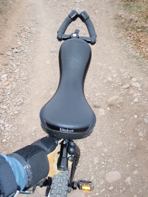

Shadow Stub-Tail Handle / Seat Protector
My “previously-owned” KH29 came with a brand new, “in the box” Shadow Handle that I wasn’t certain how to best configure.
When I started riding this bigger wheel on trails I decided that I wanted to loose the rear-facing straight T-handle for fear of getting tangled up in it during a UPD. I also discovered that I didn’t need the full length of the front, curved, T-handle, so I cut off about 5".
After making those modifications, I felt it was a shame not to use the rearward-facing handle mount for something, so I took the 5" straight piece I cut off the front handle and stuck it in the rearward-facing mount and covered it with a 7/8" rubber leg tip.
I didn’t realize it until I had ridden a few miles with this configuration, but this new little stub-tail serves two important functions: First, it makes a great, ergonomically-correct handle for pushing the muni while walking up steep hills. (See photos below.) Second, it protects the back of the seat during all drops to the rear.
In my opinion, the ability to install a “stub-tail handle/seat protector,” along with rigidness of the front handle and saddle, makes the Shadow Handle mount the clear winner in this match-up. (Although I do now have the lighter weight KH T-handle on the KH29, which I have reconfigured from a muni into a roadie uni with narrower rim and Schwalbe Big Apple 28 x 2.0.)
I have since moved the Shadow Handle mount to my Oracle 29 and have altered the front-facing handle by switching to a shortened straight bar (to lower the grips), and I have narrowed the “T” by 1" by cutting about 1/2" off of each end (to mount the grips closer together). I find this new configuration of the front handle (shown in the photos on my O29) to be just about ideal for muni and XC for me.
