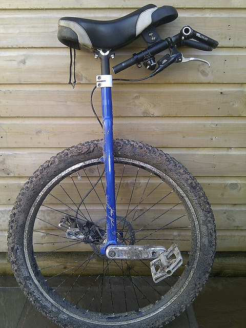

I got an KH 26 inch muni on the UDC sale and totally love it. Today i took it for a ride on the local mountain bike track. Nothing spectacular, a few steep climbs and a lot of mud, clay and narrow winding single track paths. I had a great time and the unicycle performs excellent.
Back on the parking lot i noticed that my leg armor was blue on the inside and sure enough the paint on the frame had rubbed off.
I wasn’t really disappointed, just surprised. It was my first ride on a dirt track and i have the KH for a week now. I also have a qu-ax 36 inch which doesn’t show any sign of wear after a year of frequent use. Rubbing the leg armor against the frame is not an issue there.
Is this normal for a KH frame, or any aluminum frame for that matter?

Well yes, but then again i don’t know what to expect. Anyway this is what it looks like after 4km of muni :-). I stress here that my intention is not to start whining. I just did not know it was this sensitive…
https://www.flickr.com/photos/132083116@N04/17333982125/

I’ve seen this before, had it myself - the key seems to be the KH Leg Armour. I’d ridden for months on my KH muni with no sign of wear, then I swapped my 661 shin pads for KH leg armour and the frame was down to the metal in about 2 rides. The blue paint was on the pads. I also saw it on other people’s frames - around the time that leg armour came it, it was rife!
