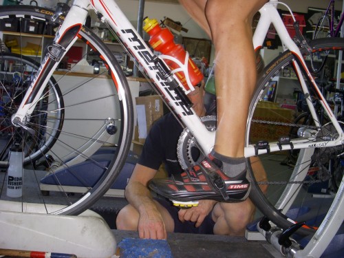

One thing that sticks out to me, is how far forward your foot is on the pedal. The spindle actually looks closer to youre heel than your toes . Try pedaling closer to the balls of your feet (try putting the spindle just behind the bony bump of your big toe). That’ll effectively lengthen your inseam.

Is that not the way to do it though? I find that when I have my foot like that, I have a bit more support and when I have more of my foot back where the front of my foot is pushing on the pedal, I feel like I’m tiptoeing and it’s a bit tiring. Like walking with your full weight on the ground as oppose to tipietoeing around the house with the weight on your toes.

I ride near the center of my foot, but that’s because I ride mostly muni. With muni, braking backwards is considerably harder if you use the ball of your foot on the pedal. But if I were riding a 36er on flats, with no need to reduce speed drastically… I would ride on the balls of my feet for more power and more energy conservation.
So you’re saying I was suppose to ride like that? I’ve had a few moments where my foot accidentally slipped back and I would try to move it back towards my heel. It felt awkward for me and a bit tiring since all the weight seemed to be pushing the heel of my foot.
So it’s something like this?

There’s some middle ground. It get’s tedious riding on the balls of your feet all the time. Cyclists don’t have to worry too much since they are clipped in, but on my road uni’s, the pedal is only a bit further back than the bike picture you posted.
Okay wow yeah I just got my mind blown by the whole foot/pedal positioning.
