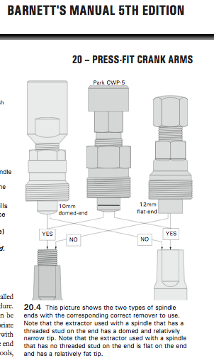

The problem might not be the quality of the extractor, but rather the age. Older extractors are designed for “nut type” cranks only and do not have a floating tip which is designed to protect the “bolt type” threads on the axle. The use of a domed-end extractor on bolt-type axles will almost always damage the threads.

Ah, that would explain it. I thought it was just a poorly designed bit
of kit. Looking at that picture, I can see that it was probably well
designed, but for a “nut type” crank.
I wish I’d seen that before I tried to do this :frowning:
