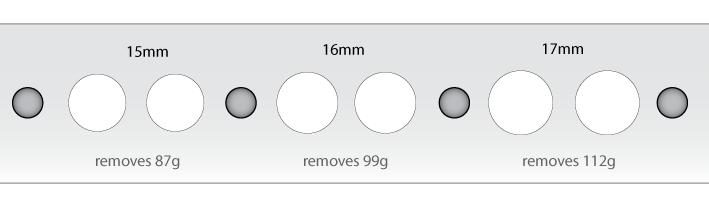

I’ve just calculated how much it saves to put two holes between each spoke. This is based on drilling 70 holes - missing the two at the valve; taking density of material as 2.71g/cm^3 (which came out just right for my own drilling pattern estimate, using 1mm as thickness for the inner wall) and taking a thickness of 2.6mm for the outside wall, based on calculating from Dave’s weight saved - that seems reasonable from looking at the valve hole.
So by drilling 70 holes of the following diameters into the visible wall of a Stealth rim I think we can save:
15mm: 87g
16mm: 99g
17mm: 112g
See attached sketch to estimate how prudent, or otherwise, this plan may look.
Sam
Couldn’t you cut bigger holes if you put one hole closer to one edge of the rim and the other hole closer to the other edge of the rim?
Yeah, possibly. Although I don’t think you can drill too close to the edge as there are internals of the rim cross-section that you wouldn’t want to hit. I think that it is the same as the cross-section on the KH29 rim. The attached sketch might be OK though.
Also, if you make the holes zig-zag then the main width of the bridge of material going from one side of the rim to the other would not be straight. Would that be a problem? I don’t know, as I don’t really understand how the material strength/structure works.
Sam
P.S. I don’t know why Illustrator has made this into a magical rainbow, but I’m not going to fight it.
How about oval holes
You could drill the holes so they are touching then grind the inside to make flat sides to the ovals. something like the Monty 221 rims
That way you would leave more material near the spoke holes. I don’t think that a skinny bridge between two holes where there is no spoke adds a whole lot to the strength or integrity of the wheel.
