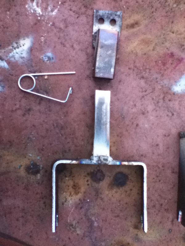

how nice would it be to toss your 36er on your roof rack?
I am thinking of making a version for other types of unicycle handle bars… is there a market for this?

If you don’t have a large vehicle a 36er is easier on top. if you are carpooling 3 riders, it’s nice to stick the muddy Muni’s on the roof… but the feedback isn’t so mediocre, but I’m torn between making an adapter for handlebars, since I have a good relationship with a fab shop, or a rear bumper which means I’ll have to get into vacuum mold plastic.

not bad, but I want to make them for at or under $50. I want to make specialized bar ends that are crushed into fork tips at the ends which will mount onto both Nimbus and KH bars and retail for the price of bar ends, roughly $30. I may make a tube adapter that attaches to the rear seat bumper for those without handlebars, but it needs to be quickly removable.
I’m thinking of two cheap adapters that bolt to existing fork mount bike carriers that are very common to cyclists. The down tube grabbers will still allow a 36er to potentially tip over on the car, and not all wheel grabbers will fit such a huge wheel.
the first type will adapt a receiver to the seat via the rear bolts of the seat post and pin a fork adapter in place for quick release installation and removal. the second will use the shadow handlebar as the receiver, and use a quick release collar for installation and removal.
