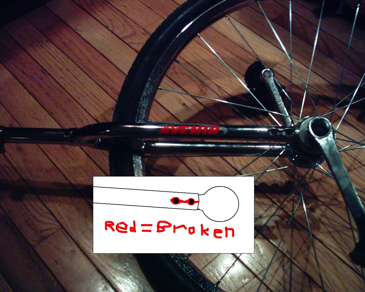

I am relatively new to unicycling. I received one for Christmas. It is a 24" avenir. I learned to ride on it just fine. It was not bad for learning. I have mastered forward and backward riding. I can idle forever. I can one foot idle forever. I can do small bunny hops forever, and I can do quick 180s and some stairs. I get the after reading online, I have begun to suspect that my unicycle was not built to do some of the things I am trying. Within the first month I managed to crack the frame of my unicycle in four places around the bolts that hold the frame to the stupid sealed, unfixable, poorly attached and designed bearings. I have done what I can with washers, bolts etc. I have been learning one footed riding recently and have found it discouraging that I have no way of even trying a better unicycle to see if it feels different. The thing creaks, shifts to the sides unexpectedly, and is overall a pain in the neck. I think I need a new uni. Is it significantly easier to hop onto things with a real 20" trials uni? Will one-footed riding be easier? I have very little money and I need a new uni fast. I may be able to have $200.00 for a uni by the end of next month. It will probably be a trials uni because I can get along just fine on my 24" for commuting. What should I look into? Can you think of any way I could find a different unicycle to just try and see what it is like? The only unicycle I have ever been near is my own. I have never met another unicyclist in person. Please help me.

The cracked frame is a common problem for lollypop bearing housings that are not made by Pashley. I had the same problem on my first 20" unicycle after riding it down stairs and drops, both sides of the frame split. This is a picture of it after I fixed the frame, stronger than new:
I took it in to the bike store and they found a spare bicycle seatpost that was made of some strong alloy. They didn’t get around to fixing it for me as fast as I wanted them to, so I took the bits of seatpost and drilled them on my friend’s drill press. It was quite hard to drill, and you could see the small indents where the bike-shop people had tried to get through it. Once drilled, it was easy to bolt the shods in place, and I never had a problem with the frame again. I kept having trouble with the cotter pins and cranks, and the unicycle is dead now. Saving up for a Kris Holm unicycle is a good idea, and hopefully your old one will last the distance in the meanwhile.

Your picture of how you solved your problem may be a life saver. I know a guy who does some welding and your plan looks like something he could handle. There may be some hope for this Uni yet. I will still buy the KH as soon as possible. My Uni was not built for trials and I dream of a handle on the seat so that I will no longer shred and mangle my fingers on the screws sticking out of the bottom of my seat where I need to grab it.
