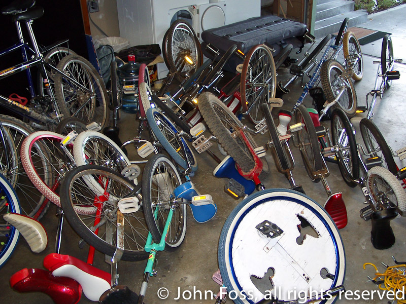

28+ years. I still mostly suck at it. I built my first Ultimate Wheel in 1986. I should practice more.
I built mine from a Unicycle Factory Ultimate Wheel kit. It’s essentially a bracket to attach the pedals to. You supply the rest, including a piece of 3/4" plywood to fill the rim. I made mine pretty, with a blue alloy 24" Miyata rim. I used a sabre saw to cut two Uni-Cyclone-shaped holes in the wood and painted it nicely. I brought it to the 1986 National Unicycle Meet, which was followed by the second Unicon.
IUF founder Jack Halpern ended up losing his on his trip there, and wanted to buy mine. It was less than a month old, and I had barely spent any time on it. So I offered him a riduculous price ($160 in 1986 dollars), and he accepted! So it went to Japan and I was again without my own UW.
14 years later, Jack brought it to Beijing for Unicon X. It looked a lot older and had been sloppily repainted, but was otherwise fine. He gave it back to me and I was able to bring it back home.
Anyway, don’t follow the above sequence if you want to become an expert Ultimate Wheel rider. :slight_smile:
It’s in the foreground in the picture below, which was taken in 2002.
