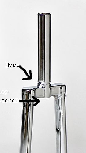

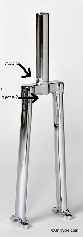

Do you measure the seat tube on a freestyle above the flat section or below. The reason I am asking is because if it is below I will fit a 300mm tube, otherwise I won’t.
i think you measure it here instead of Here but im not sure
At the top, because usually the seatpost won’t go below that point.
Depends, some frames like the old nimbus the post can drop right through so you measure to the bottom, frames like KH don’t drop through so you measure to the top. Everyone cuts down their posts anyway so don’t worry about it, just take a hacksaw to it if it’s too long.
The key dimension is from the top of the tube to the lowest point your seatpost can go. If you’re not sure if the post goes all the way through, feel the inside at the bottom and see if it’s 100% smooth. If not, the post may not be able to go below the “bumps.”
If it can go through, you have all the way to the tire, but be aware of changes to different tires that may be bigger.
