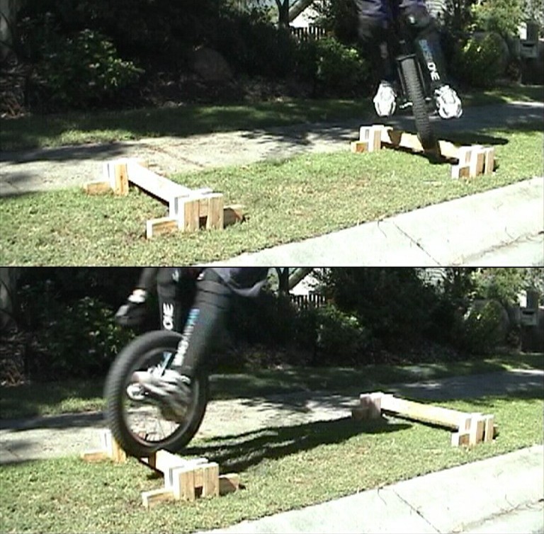

I can’t seem to hop off gapping bars (like the ones on Andrew Carter’s site) with any force. My tire just compresses and I feel the rim bottom out against it and I only get enough upward force to barely make it off the bar. I’m riding on 25 psi on a KH20 Trials and I weigh 150 pounds… Anyone else have this problem?

I guess you aren’t jumping on the centre of the wheel. You lose height if you jump off the front or back of the wheel. Some times you don’t even notice you’re like that. Maybe someone can elaborate, I’ pressed for time.
David
Ah, now here’s a thought…when I jump from something narrow like a 25mm wide gapping bar, I have the wheel at about 30 degrees or so to it. So more of the tyre is in contact with the take-off surface and there’s a larger area pushing back on the wheel. I usually land at about 60 degrees, more if it’s a bigger gap.

Looks like this for me.
