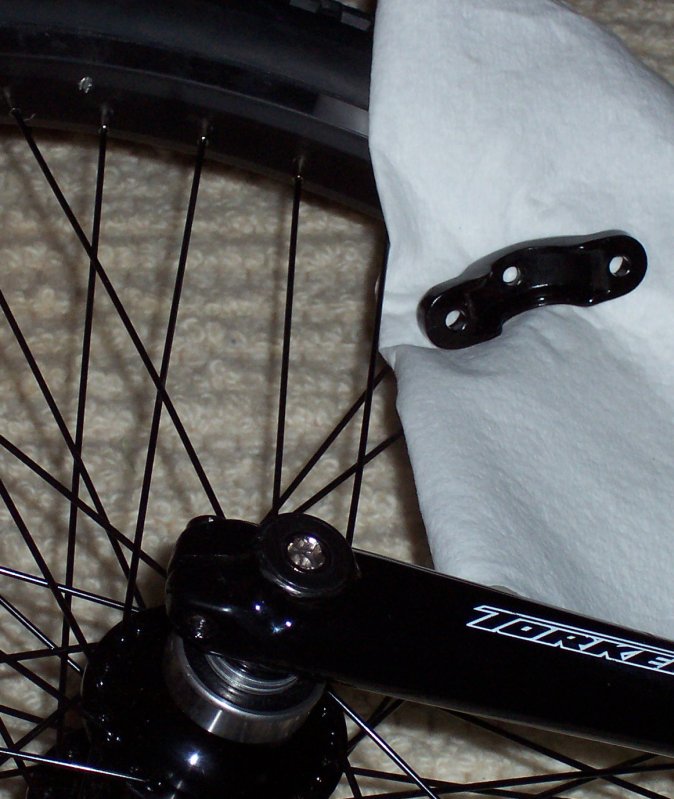

Here’s a look at the bearing holder.
There were no spacers.
The bottom holder acts as a ‘basket’.
It could fit a bit snugger on the bearing, but I dont think thats an issue.
Also, if you inspect my photo well, you will see 'part of 'my original complaint to the seller.
