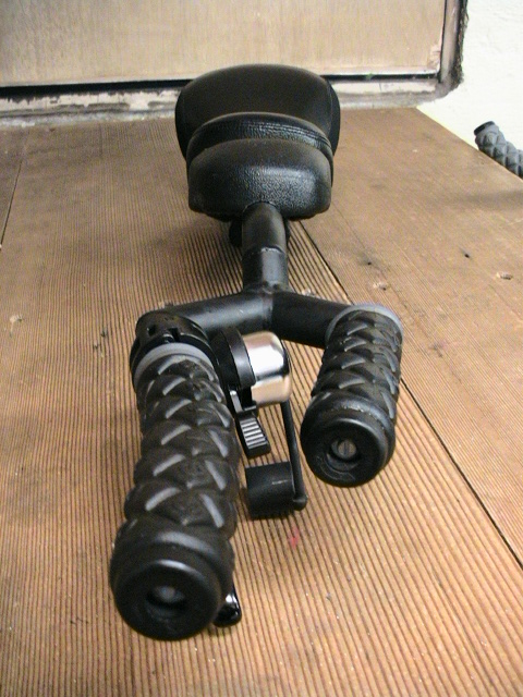

No no..that isn’t the best setup. You can easily create a bracket out of 1/8" steel that fits underneath the seat at attaches to the front seat bolts. This avoids the rail adapter, and works perfect for short riders (like myself and my 5’2" girlfriend).
Very stiff, and won’t break your plastic seat base.

I think so; I think the main advantage is my grips instead of a standard KH handle.
I have two problems with building the handles:
  1. I make them out of old bike handlebars, and I’m out
  2. It takes a long time – mainly to grind things to the right shape/angles. The welding itself doesn’t take that long at all.
I can solve #1 by buying steel handlebar stock, and a pipe bender. I’m not sure how much a useable pipe bender would cost, and I haven’t priced handlebar stock (really, just steel tubing of the right size would work).
I can solve #2 by figuring out how to properly cut circle shapes in steel tubing. It probably involves some special tool which I don’t have.
I need to investigate these items before I really consider producing any quantity of the handles. If anyone who has metal fabrication and welding experience knows the answers, please let me know!

That’s a very neat setup. Looks like it won’t weigh a ton? No annoying rail adaptor / rail post needed, and the front bit is close enough to the seat to be useful for offroad. On the T7 you just have to use the KH handle on anything hard, and at least to me it seemed like the KH handle didn’t feel nice to use when you have the T7 coming off under it, this looks like a more integrated design.
I wonder if there’s some way you could make a design almost like yours, but using straight tubing and some more welds - it does look like the bending is going to be hard to make.

Yeah, it isn’t too heavy; definitely lighter than a T7 since it uses less steel. But, in the end, it is steel. An aluminum, or some lighter-yet-strong-alloy would be ideal. However, I am limited with what I can weld with an oxy-acet torch setup.
I think straight tubes w/more welds would work; I may end up making some of those kinds too at some point. I really just need to figure out where I can purchase handlebar stock for fairly cheap (ideally local). So far, all my steel has been free, from old bikes that were given to me.
