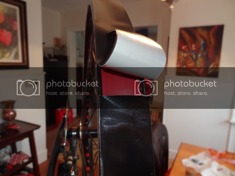

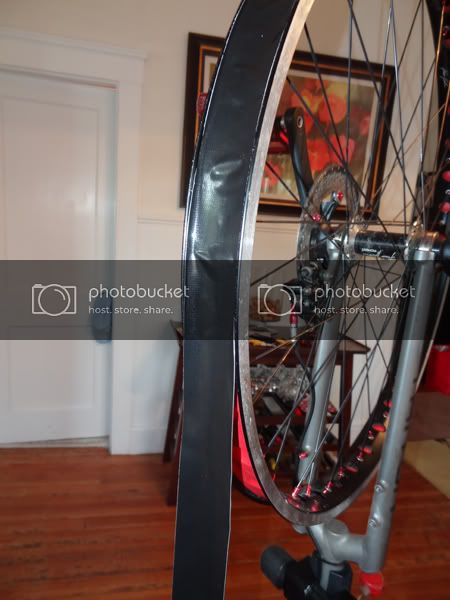

I decided to give the gorilla tape tubeless a whirl on my KH Freeride rim. I wasn’t sure how well it would work with a drilled rim, but I figured I’d try.

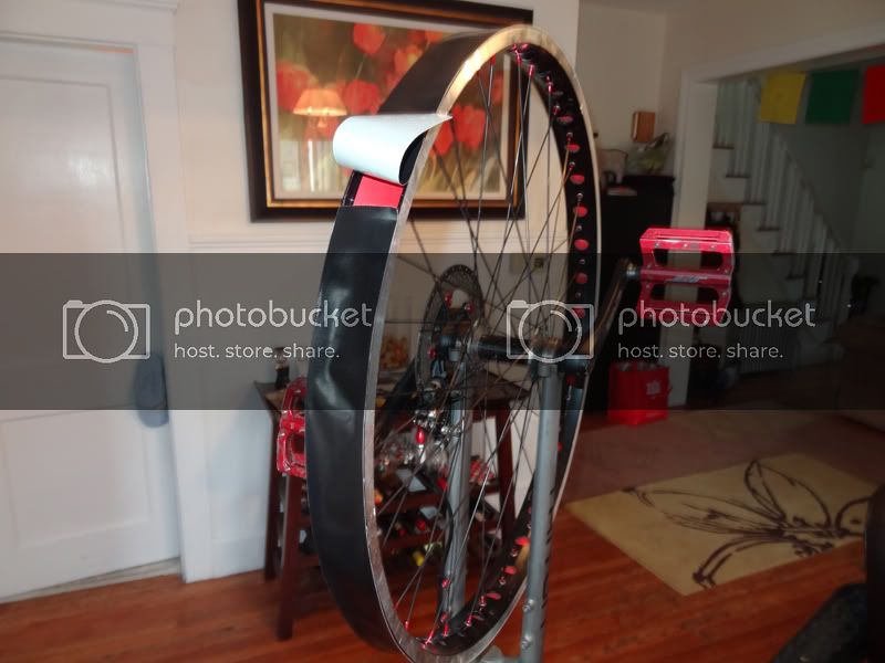

The 44mm Gorilla tape from Home Depot was a perfect fit! I laid the tape on the outside edge to get a measurement so I could cut to length.
Once I had it cut to length I started applying the tape directly to the center of the pre-existing rim tape. This allowed for a slight overlap on the bead. This would ensure a seal around the rim strip and tighten up the bead a bit, since neither the Ardent, nor the rim are tubeless ready.

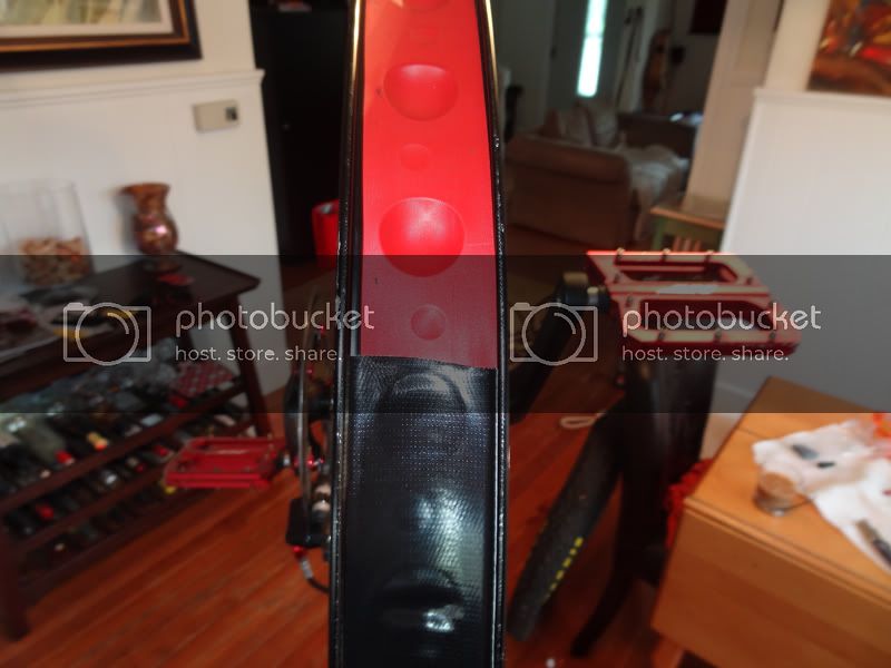

I found that I had air pockets forming over each drilled hole, since the rim strip had already stretched and bulged through.

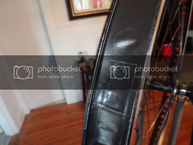

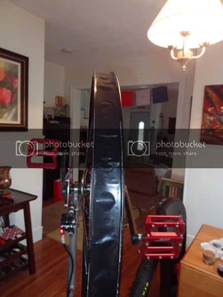

Once the taping was complete, I did what I could to get the tape seated around the edges and in between the drilled rim holes.

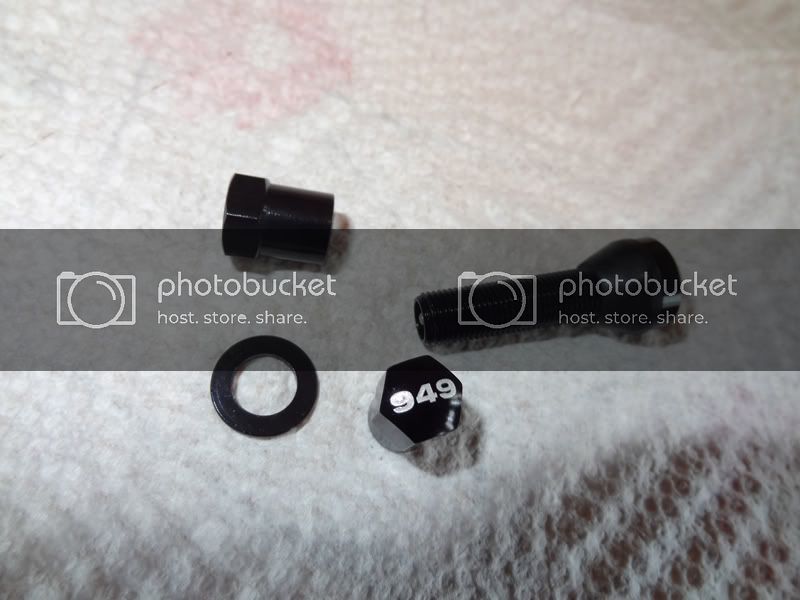

here’s the valve I’m using from 949 Racing. It got good reviews from some mountain bikers.
I threw some extra layers of tape over the valve hole.
cut the hole.
Applied a final layer and cut an X. Smoothed the tape down into the hole to clean up the seal.
The 949 Racing valve has one draw back. With double walled rims, the nut is too long.
After cutting the nut down:
it installed quite nicely:

My initial inflation held (poorly) about 10 pounds. I slowly sloshed the sealant around until the air leaks stopped. I repeated this process: 18 pounds, 38 pounds. It’s holding well there. I did hear some air leaking a few minutes later. Sloshed the Stans again and it stopped. I noticed I did have some stans leaking around some of the drilled rim holes. I was hoping that I wouldn’t see that, but I don’t think it’s going to be an issue.
I’m sloshing it around every 15 minutes or so for now, but the 38 pounds are holding well!
I capped the valve and am waiting patiently for this to seal up and dry.
I was running 13-15 PSI on my last ride with a tube. It seemed to be just enough to prevent rim strikes and sloppy handling. I’m not sure how the soft sidewall of the Ardent will hold up to such low pressures without a tube, but I’ll report back when I find the “sweet spot.”
