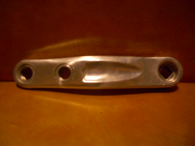

Hey everyone. Was just looking for a little advice from some of the commuter guys and girls on these forums. I am currently training to do a uni tour mid way through next year (details when it gets closer to fruition!).
I’ve got a nimbus 36" with t7, airfoil and 152 mm cranks. So far i have found it to be a really nice ride for hills, but a little cumbersome for flat sections that could be done easier with shorter cranks. I know people ride 110’s and even smaller for flat fast sections- but lugging around a crank puller and a spare set of cranks for a ride is not ideal. So i am asking if anyone has gone and got their commuter cranks engineered to take their pedals at different lengths?
The cranks i have at the moment are quite beefy but have fluted surfaces ( i assume to reduce the weight) on both sides of the crank. Do you think getting second pedal threads put in my cranks at the 110mm or so mark would reduce the cranks strength in a way that would cause problems when I’m cranking up hills on the longer 152mm option?
If the structural integrity of the cranks are in question, do you think that putting in a dummy pedal spindle in the 110mm pedal hole when riding the 152 option would help increase the strength? I’m thinking i could get something engineered that would be like a 15mm allen bolt that could be easily inserted and removed from the crank.
Any advice you could give me on this matter ( or even your preferred crank lengths for different riding terrain) would be really appreciated! I’ll attach some pics of my cranks for you to look at.

people have certinaly drilled prowheel cranks for an extra pedal hole, but I don’t think it will be possible with the cranks you have currently because of the large dish taken out of them. If you search for previous threads on the subject you might find someone in Oz who has the appropriate tools, unfortunately pedal thread taps are quite expensive.

Have the area where you want to tap the new holes built up with weld. Then drill and tap your new holes. This should be easy enough with steel. I haven’t experience with alum welding, but I think that should be do able as well, and lighter . Steel might be a good choice if you plan on moving the pedals a lot, the threads should last longer.
Plugging the unused hole will not add any strength, so don’t bother with that.
W/ welding aluminum you’d need the cranks to be heat treated afterwards.
I don’t think it’s realistic to expect that you’ll be moving your pedals from one crank hole to the other multiple times every day on your commute. Even leaving aside the factors of hassle and grease, pedal threads are not really set up to take that kind of use; at some point you’ll cross-thread one and then you’re hosed.
I think your best bet is to get 125mm cranks, or at least 140mm, and just get used to climbing hills on them.

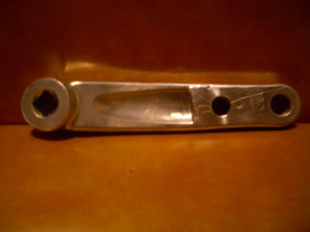

I went to an engineer that is a friend of my family today with my unicycle to ask his opinion on getting my cranks drilled. After a bit of a chat he was enthusiastic about giving it a go- we decided on getting a small cylindrical insert- threading the inside of it to take the pedal, then drill out a hole in the crank then weld it on both sides of the crank to hold it in place. I’m going to take the cranks there on monday (want to put in some km’s this weekend) and will hopefully have it done by Wednesday. I just need to make my mind up on my second crank length. At the moment my mind is leaning at something between 100- 110mm. I hear people get used to the shorter crank lengths if you use them a lot so i’m thinking of going shorter rather than longer and just using the 150’s when i get to a bitch of a hill. What do you think?

How do you know that? I think it would add strength. I imagine that the crank would fail at the spot where the additional hole was drilled, and that the wall of the hole would buckle inwards in the process of failing, or at least become “unround”. Plugging the hole wil prevent its deformation and hence resist the failure to some degree. Napalm’s engineer friend might be able to say whether it’s enough to be worth it.

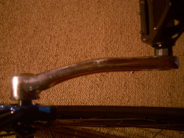

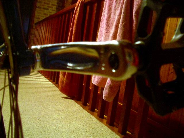

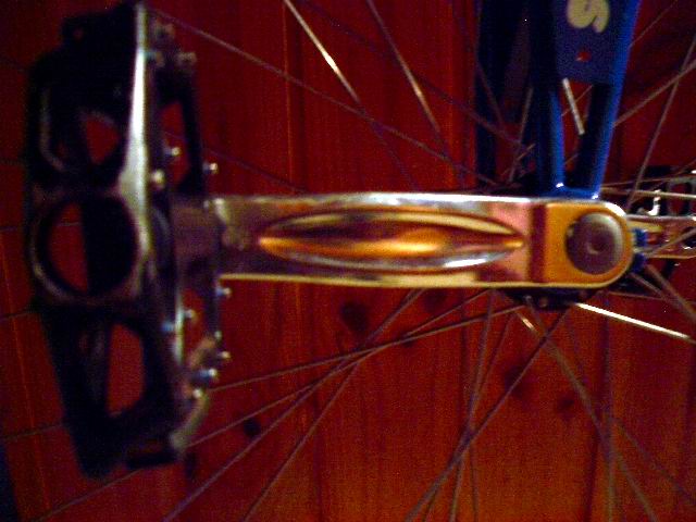

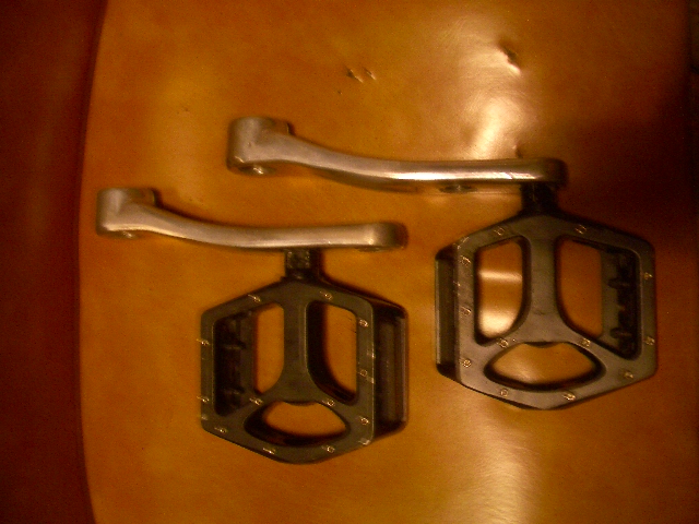

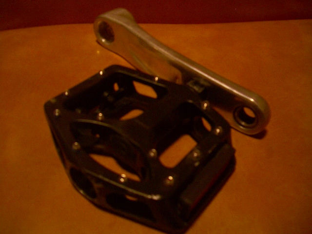

Ok well i got the cranks back form the engineer today and they look like they should work really well (have not been able to test them yet as my Uni is in the LBS getting a caliper brake and some other stuff put on it). Here are some pics for you guys and girls to look at if you are considering doing something similar to what i have done. Will give you an update on the whole setup after i have given it a considerable road test. You can see from the pics that he filled in the fluted part of the crank (front and back) where the new pedal hole goes. It seems as though this extra material will help strengthen the crank around the new hole. Oh- the crank length is set at 152 and 110mm.

Those look really cool. Props to the engineer.
