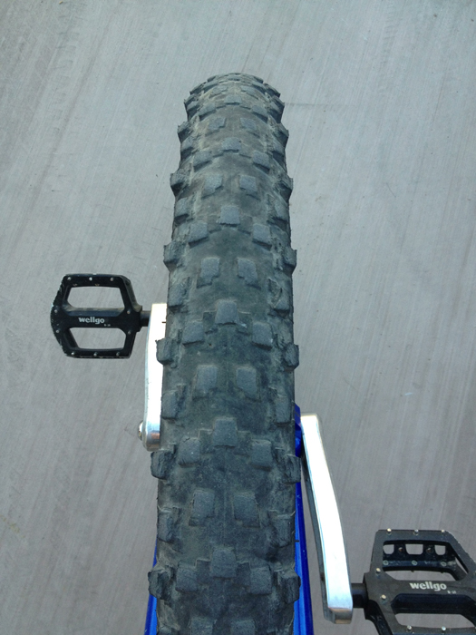

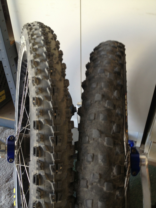

Going fast in high gear. The 26 is more squirrely and not as smooth on the rocks. But my biggest problem is stability. It keeps lurching to one side or the other. I ended up doing a fair amount of arm flailing when this would happen at speed. My back is sore from fighting this. This is a bit puzzling. I never had these problems on my 29er which is not as wide as the 24. I got home and looked at all three tires. I think the profile of the Ardent is the problem. It has that high center ridge, whereas the 24x3 Duro and the 29 Stout are much more gently rounded.

I don’t like the looks of the profile of that Ardent tire. Tires with a narrow center ridge tend to push you to one side or the other; I like tires with a more rounded profile, whether they’re fat or not. Definitely try something different.
You’re not the first one to complain about the Ardent having a tall centerline and being twitchy.
But keep in mind that you are comparing a well worn fat tire to a brand new mid fat tire, so there is break in and adjustment that needs to happen, also getting the right tire pressure could help; higher pressure for skinnier tires. I’d ride it for few weeks and beat it up a bit, then make a decision.

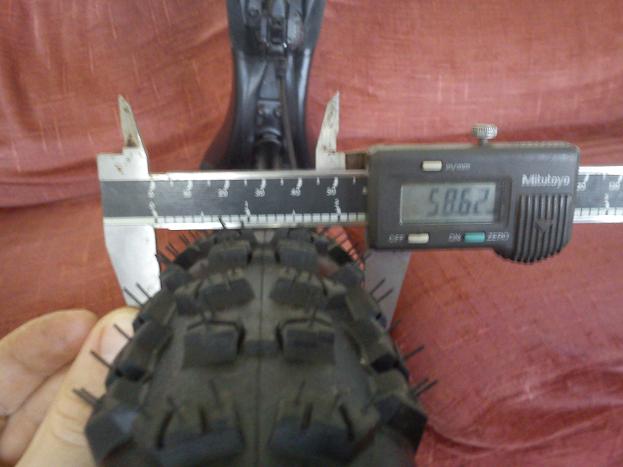

Both the High roller and high roller 2 are great tyres for muni- the super tacky and 3c compounds are very grippy. The High roller 2 2.4 measures out to roughly 58mm on a KH rim and is a good tyre very grippy :slight_smile:
