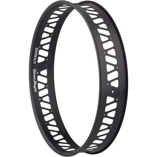

You could easily build a wheel at motorcycle dimensions using bike parts these days. Like, here’s the Surly Clown Royal rim, 24x100mm, designed for a 6.2" tire.

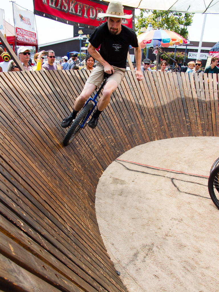

Our friend Josh Tulberg is the only unicyclist I know who’s successfully ridden the WhiskeyDrome.
Imgur
This is on a 24x3" Duro. He tried it the next year on the Nimbus Oregon, 26x4.5", and didn’t get all the way around.

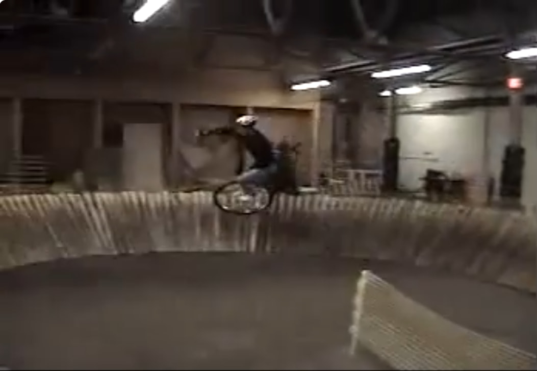

@tholub That’s super cool! There’s no run-up, so I’d never be able to get enough speed on my 36er to ride something like that, but I sure did have a lot of fun when I went to Ray’s MTB park 20+ years ago and rode this:
That bank is not there anymore, but they may have something similar. A trip back to Ray’s sure would be nice!
