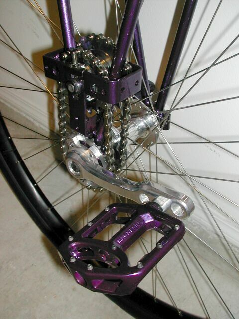

I give you…PURPLE PHAZE!!!

Thats one sweet paint job! Lets see a full pic.

This is all i have right now. My digi cam sux.
oops, try again:
That’s a nice painjob :sunglasses: , co-ordinated with the pedals even!
Hey, what cranks are those? They look quite solid despite the triple drilling.
forged daVincis, drilled for 130/150/170.
Wow, awesome paintjob!
How much were those cranks? Can you get them just for unicycles?
Daniel
they’re actually tandem stoker cranks i’ve had for a while and seemed perfect for this project while i figure out the final crank length. the spider screws in to the crank, so it’s removeable. prices for forged cranks these days are likely high due to made in America…i have no idea how much.
i’ve also gotten cheap cranks from recycled bike parts and drilled them to whatever i need, but i’ve never tried doing triple drillings. if i did i wouldn’t consider making pedals holes less than 20mm apart.
by the way, the more i ride a geared 36, the more i like it. it was unknown territory 2 weeks ago when i started, but already doing freemounts no worse than my direct-drive, and getting better at low speed manuevering. and i’m no great rider, i started uni 13 months ago. i’ll eventually try gearing more than this 1.5 overdrive.
folks, this is absolutely the future of road unicycling. if anyone knows a company willing to make these, i’d be happy to talk. i can see putting a jackshaft on a single-leg frame too.
