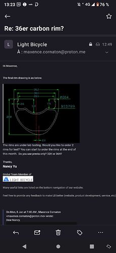

With a combination of the larger BSD (Bead Seated Diameter) and taller side of the new version Nextie rim, it should prevent the current 36" tires from blowing off. The standard 36" rim BSD is 787mm. I guess the question would be, will all 36" tires fit on the larger 789mm BSD rim?

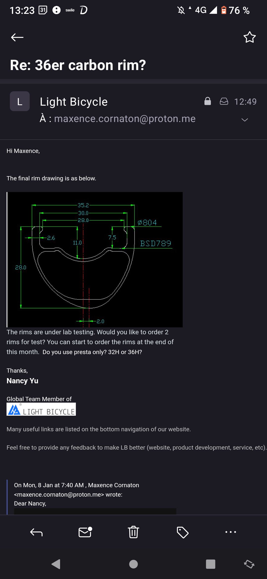

Which new version of the Nextie rim are you talking about? The drawing I have sent is the new LightBicycle rim. Have I missed a new version of the Nextie rim? :thinking:
I’m pretty sure the 789 BSD is the new one used on the Dominator2 rim - which is why LB have copied it.
And that rim will take all known tyres so I would hope it works fine.

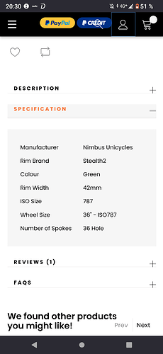

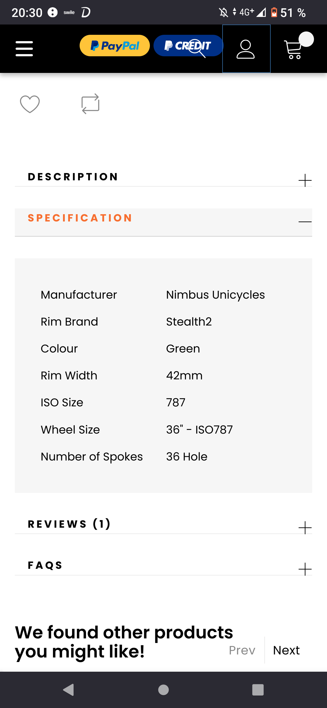

Is the Dominator2 rim using a BSD of 789? Based on the specs from UDC UK, it is 787 :
Am I wrong?

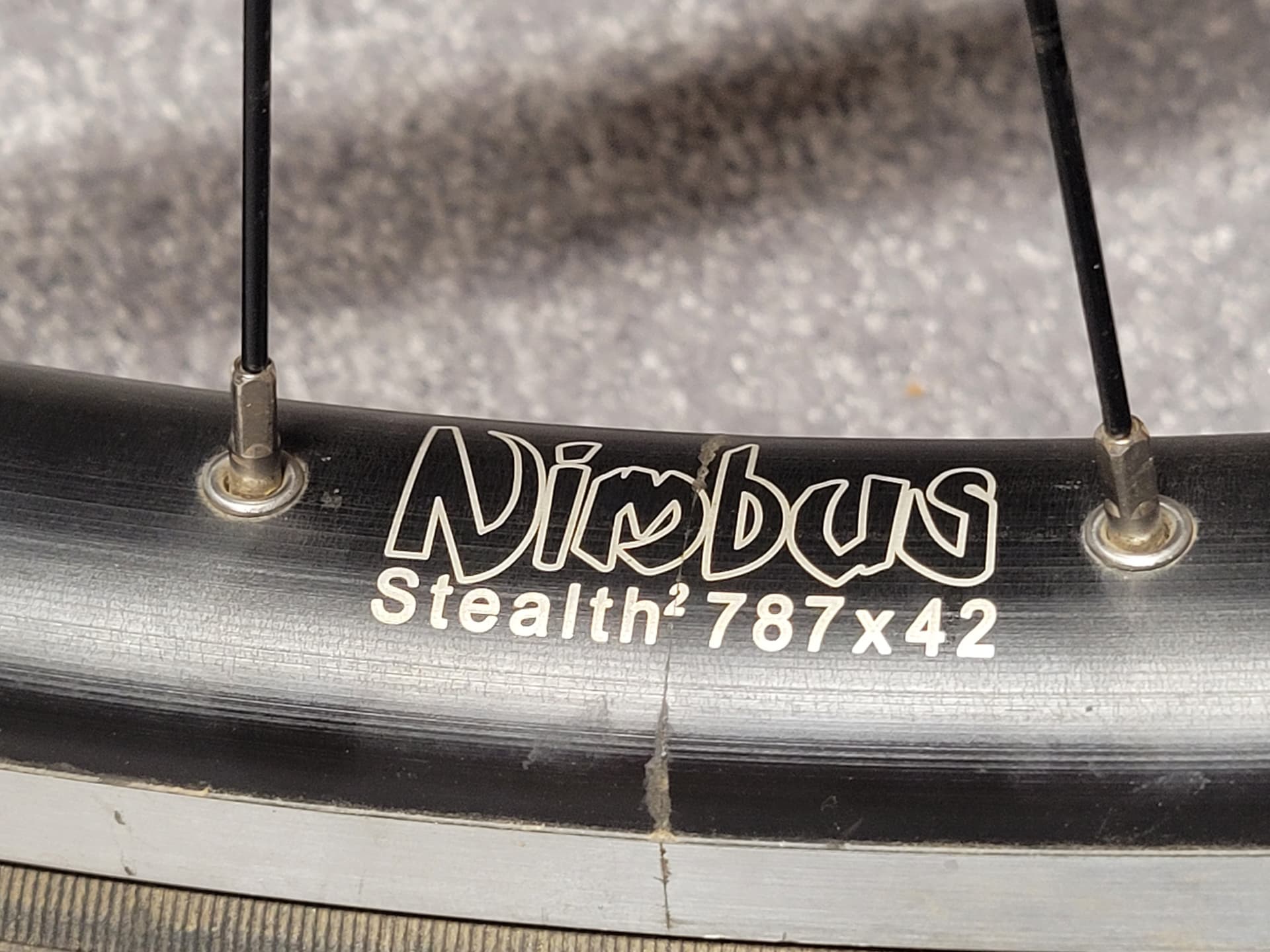

Nimbus Stealth2 787 BSD
Thanks for the confirmation. All 36 rims and tires I know are made to match 787. I kind of remember Roger talking about the approximation behind the size of 36". Could LB have found that 789 would be better to match our current tires, so that every rim should have a BSD of 789 instead of 787? I have sent a mail to Nancy to request more information.
I may have got my wires crossed it was from an email exchange with Roger, Nancy and myself where actual production specs were confirmed to have a ETRTO of 789.
So I think it was the tyre that was tweaked to 789 - although reading back my emails it could still be the rim (Dominator2) — As it was confirmed with “the factory” but I can’t now gauge if this was the rim or tyre factory.
I guess a rim made to 789 BSD might prove harder to install a Vee tyre but better for all the others. Having said that the Vee installs fine on the D2 - if we presume the rim has been marginally tweaked there, then we’re good all round.
