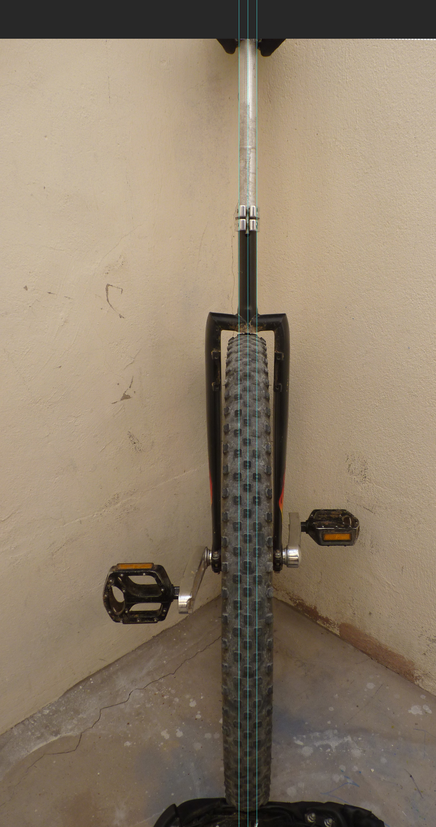

There is 1 to 2mm difference between the rim and each frame “arm”, the distance is different if I turn the wheel a little but it is never inverted, so there is somewhere 1 to 2mm asymmetry. Could be the frame. Do you think such a little difference could create such a loss of balance if I’m sit higher on the seat.
I take a picture and use photoshop rulers to see if there is asymmetry (not much), sorry for the huge picture :
Picture without the rulers: http://i.imgur.com/WvBreEP.jpg
Any thought ?
That’s pretty dead on. 1-2mm shouldn’t even be noticeable with a tire that wide. The tire itself could almost have that much variation in it. do you happen to be riding on a cambered road? Try riding down a path where you feel like you’re off center, then turn around and ride back down the same path backwards. Do you feel the same thing? I think you covered that with the saddle flop, but if you did and out, then changed the saddle and rode back, you would experience the same thing.
