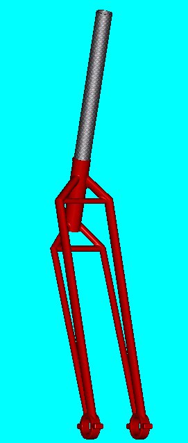

Here’s a frame that was drawn quite a while back. The features I tried to incorporate are as follows.
  1. Have a sprung frame for a cushioned ride.
  2. Utilize a standard angled CF seat tube. (I know that’s not original, but it’s a good idea to use stuff off-the-shelf).
  3. The rear (small) tubes can be slightly bowed to provide a spring that becomes tighter and self limiting with higher loads.
  4. Have the frame behind the knees that bend forward (usually).
  5. The wheel may bounce more forward when striking an object due to traveling in an arc in relation to the pivot point. (this one’s a stretch).
  6. Provide clearance for wheel walking.
I didn’t detail the rail head of the CF tube. I have an animated version of this file if someone wants it.
Doug
that frame was for a 24" wheel.
one for a 29er would be slightly different.
Doug
i’d like to see your animated version if its not to much trouble.
