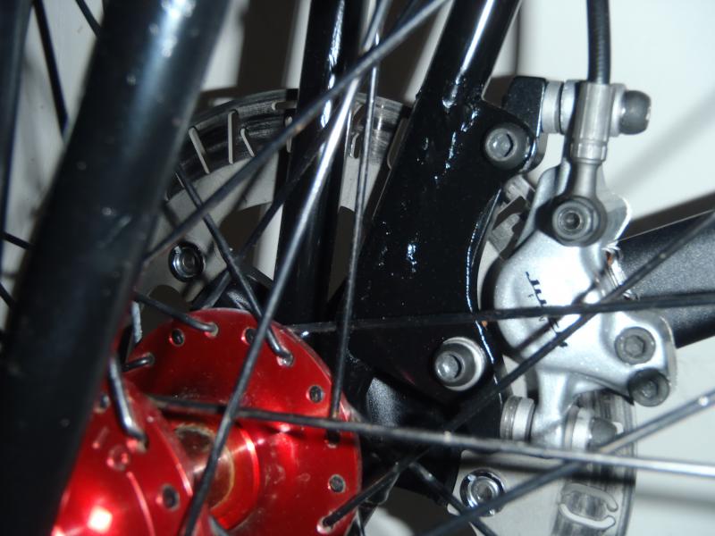

Or Weld a mount tab onto your 26" Hunter
Or you could keep your 100mm hub, weld on a steel tab mount to your Hunter, and continue with Nurse Ben’s suggestion for a Mountainuni Disc. See attached pictures. Thanks Ben :slight_smile:

I already own an Oregon - Rick Hunter frames are not that expensive - I never seem to do things the easy way and I like the clean look of the disc inside the frame - May jsut have Hunter fab up another frame with the spacing at 125 with brake tabs.
