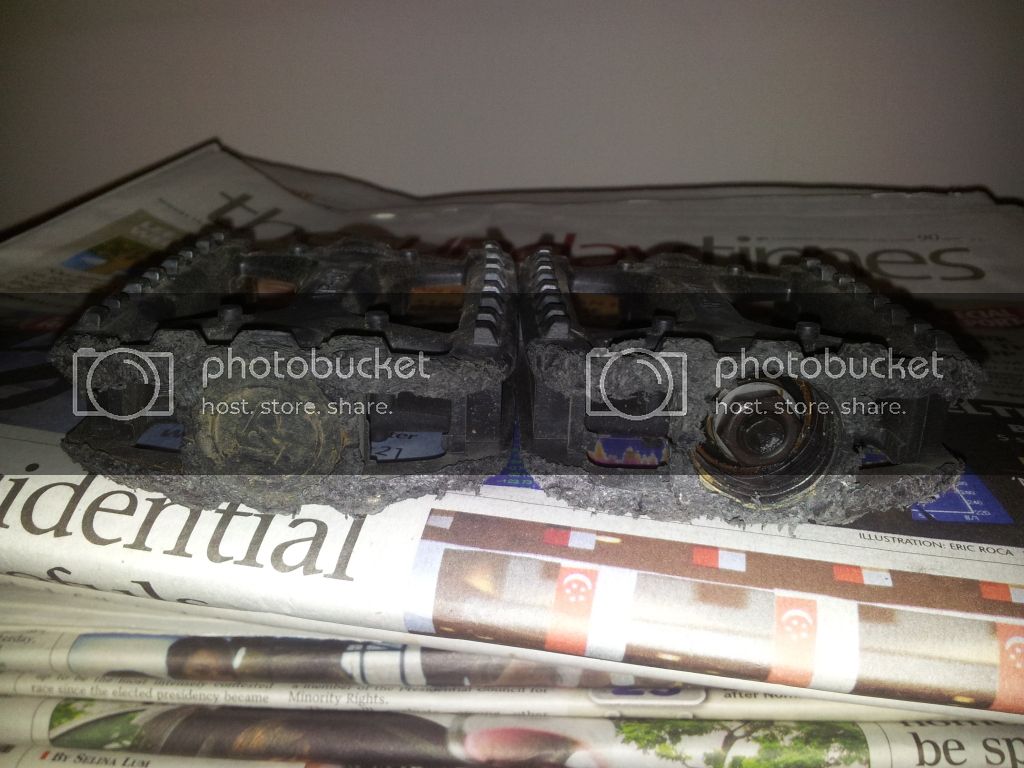

Crap cheapie plastic pedal. I used it for a few days when I was learning. Not much grip, feet can slide around.

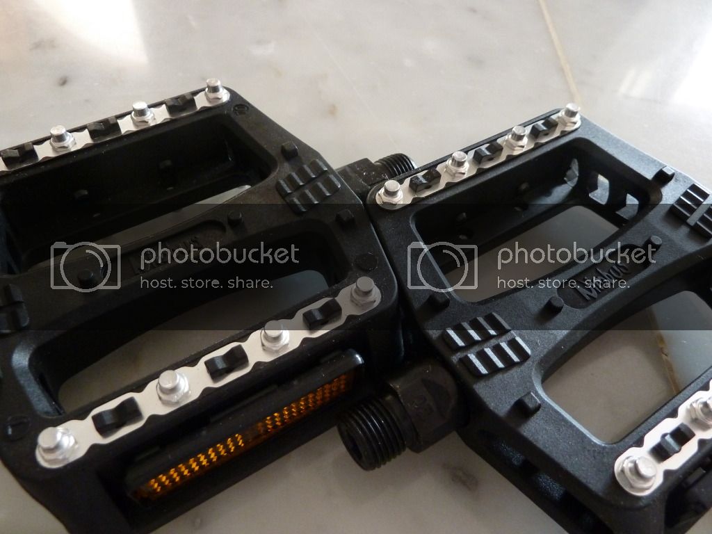

This is a nimbus pedal, something like this is more than enough for smooth riding or muni.
This is a wellgo pedal. Notice that it is identical to the Nimbus.

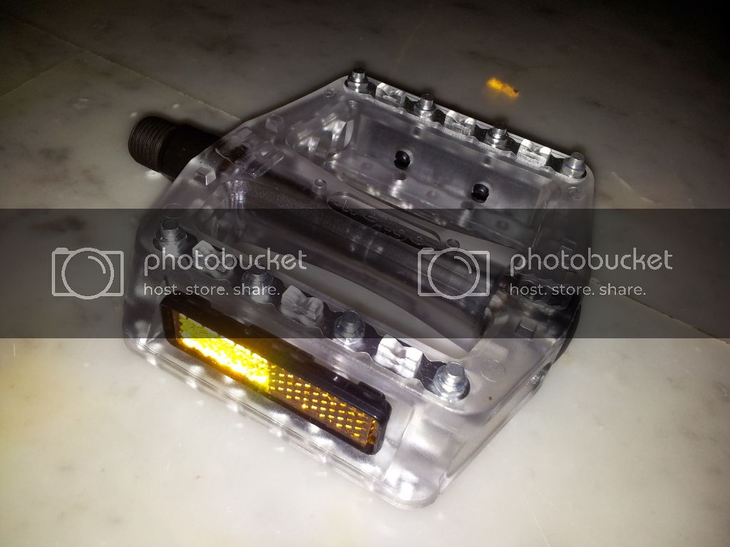

Odyssey Twisted PC Pedals. Lots of people love this. Plastic pins, but I’ll still wear those kneeguards. As a new rider I find it too grippy, gives me trouble when I’m trying to reposition my foot. Not sure if slippery when wet.

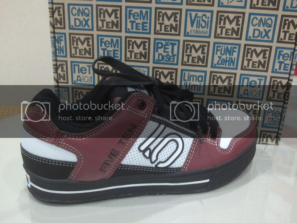

I wear these 5.10 shoes. This picture was taken when it was new. Much dirtier now. :roll_eyes: I think any shoe with a flat base would stick well to pedals.
