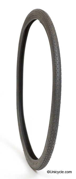

the first is a picture of an uninflated tube and the second is of a tyre …the tube goes inside the tyre and then the tyre goes onto the rim.
