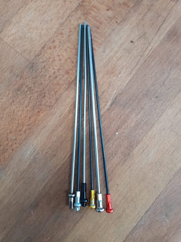

To add to the conversation/confusion regarding having to know what nipple type you are using, I bought some of these ERD sticks a while back so I would always have something set up for the particular nipple I was going to build a new wheel with before I ordered the spokes. As you can see from the picture, the different nipple types shown will have different amounts of spoke thread inside them and hence that will affect the spoke length you need. These are supplied with the nipple thread-locked on to set it at the “proper” length for thread engagement (as determined by a professional wheel builder).
As I recall these are ‘set’ to be 150mm (from memory), so you just put them in diametrically opposite holes, measure the distance between them and add on 300mm (assuming they are actually 150mm). The accounts for the nipple type and thread insertion. I have been using Sapim Double Square nipples for recent wheel builds and as you can see from the phtoto these have more thread engagement and hence required slightly longer spokes (nominally at least).

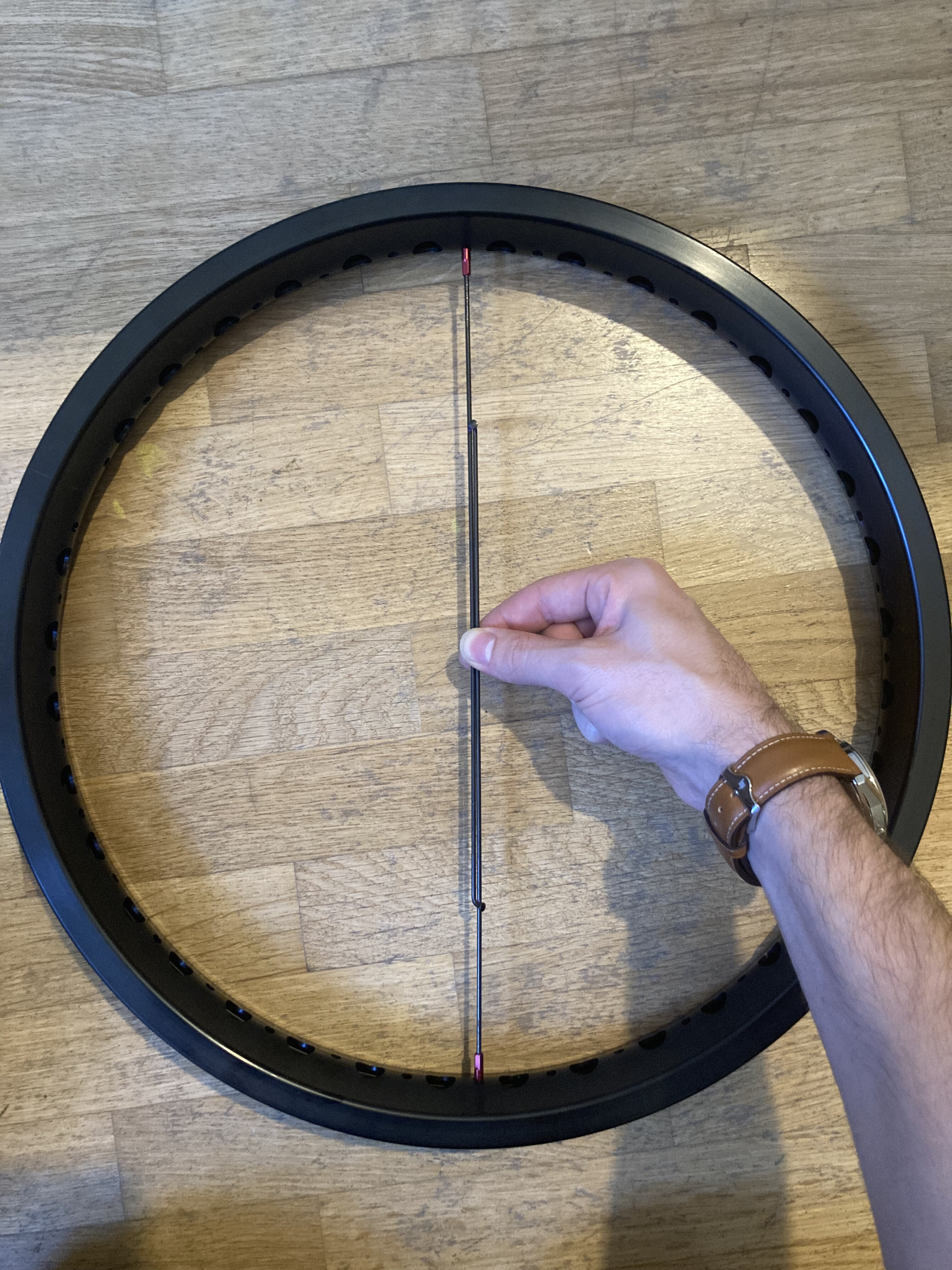

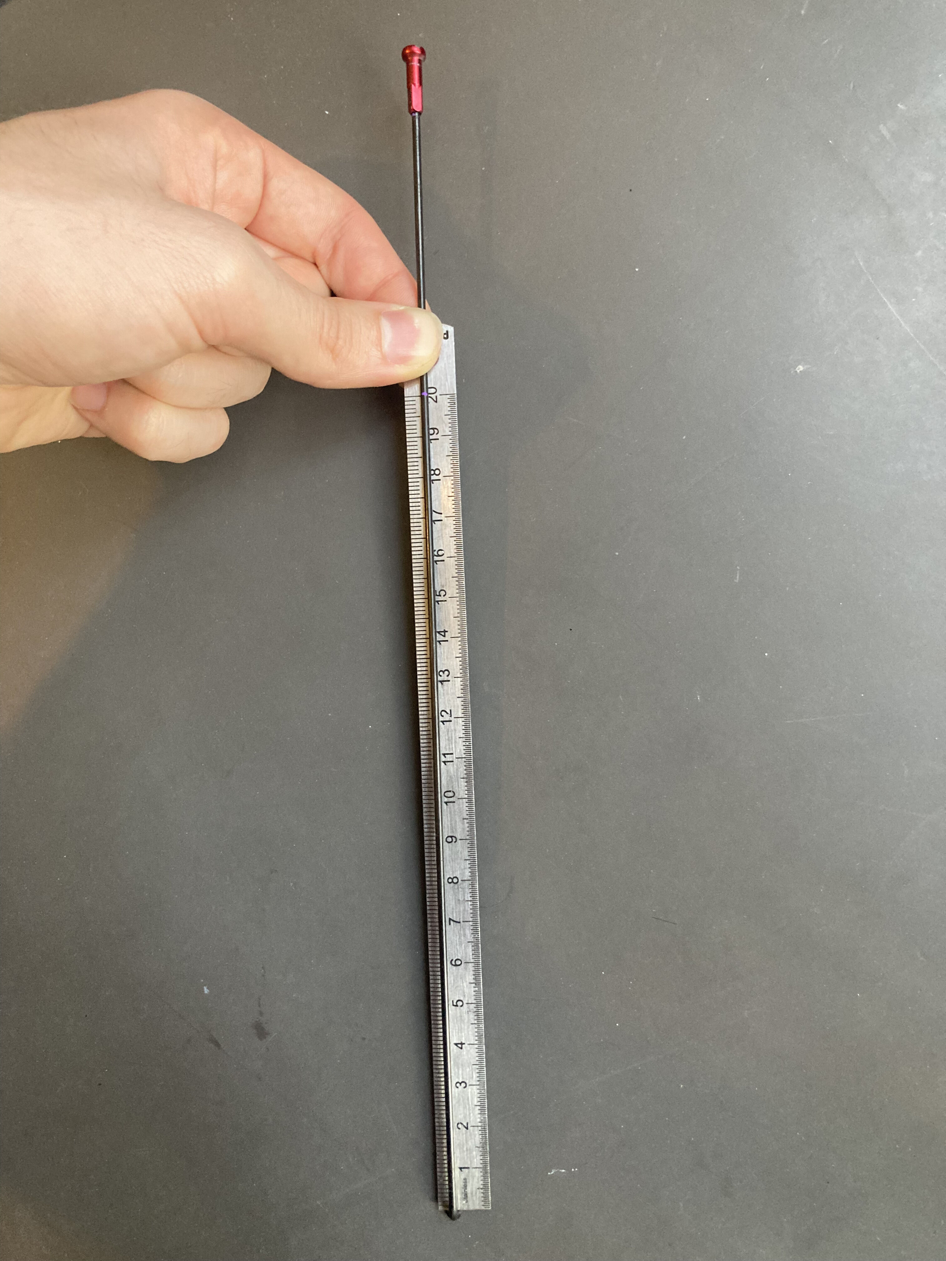

I measured 361mm
So very close from what @jaco_flans have in his notes.

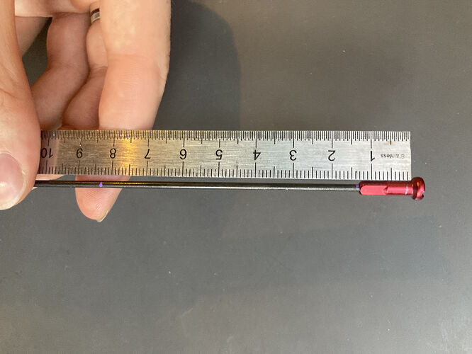

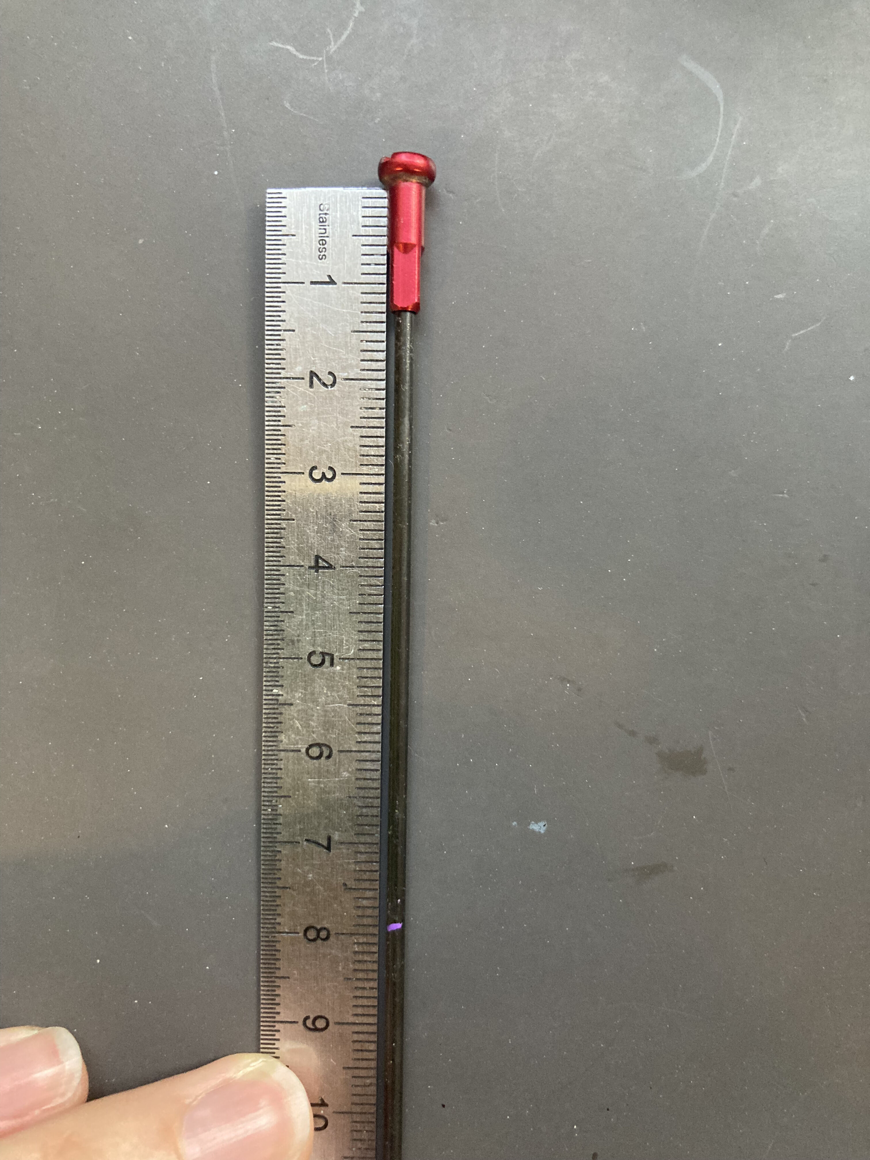

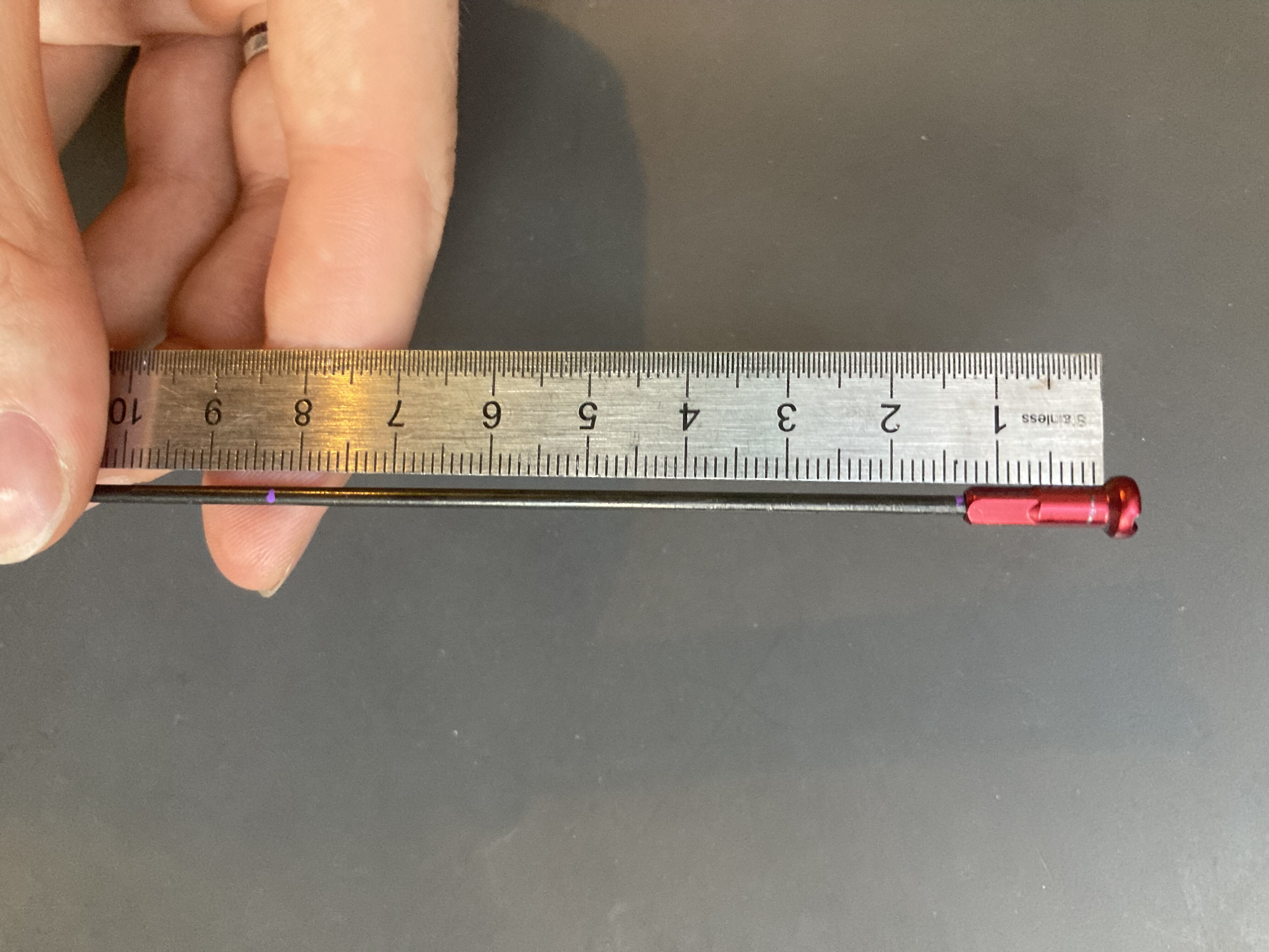

Here is how I measured it:
I took two long spokes and measured the length of the first spoke entirely from the bottom of the head of the nipple to the end of the spoke (in two times because my ruler is only 200mm long). And then I measured the second spoke from where the first spoke ended to the nipple.
I got 200mm + 83mm for the first spoke and 78mm for the second => 361mm from one nipple to the other
