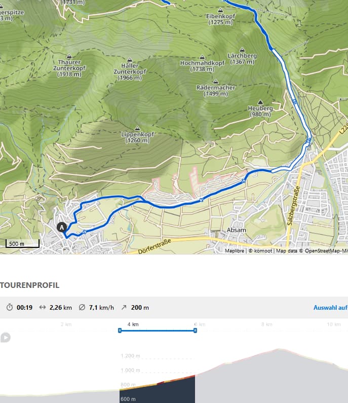

Recently I had a longer (by my standards) hill climb on my 36er. Didn’t manage to ride the whole elevation of around 180m, but I did a lot better than a month or so ago. And for the first time I saw the appeal of using a uni for hillclimbs. I guess that has to do with me slowly becoming a better (and fitter) rider, thus reducing the need to constantly focus on not falling and enabling me to enjoy the ride and the surroundings. Hope to someday be able to ride that hill in one single go.

I’ve switched from arm-chair analysis to collecting real world data. :slight_smile:
My findings so far with my 27.5" with 137mm cranks:
I can efficiently ride up to ~10% incline for a couple of 100m of altitude gain, and maintain a climb speed of at least 10m/minute. But if it’s a bit steeper or if the surface isn’t smooth, the efficiency quickly turns into exhaustion. :slight_smile:
It’s a fine line: If the surface and the incline is just right, I ride with the hands on the T-Bar handles and the movement feels efficient. A small deviation towards more incline or some bumps, and I have to grab the center bar with one hand and balance with the other hand. In that mode, after perhaps 50m I am exhausted. :face_with_spiral_eyes:
Let’s see, how far I can move my “incline-threshold” with some training. Currently I feel, it’s the power in my legs, and not the cardio which is limiting me.
