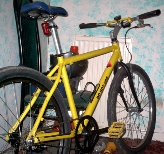

Hi all. I read this thread back when it started and decided to make the old bike I had in the hall (and the cheapo ladies bike that I inherited in the boiler-room at my new job) into a fixed gear bike. That is, a bike with no freewheel and only one gear.

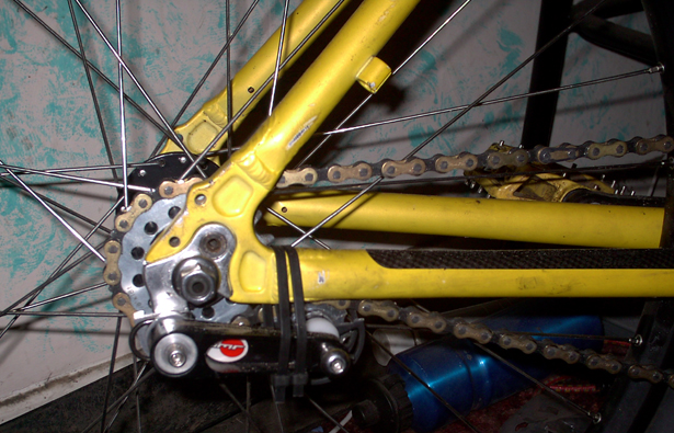

The frame I used is a Viper F22 16" mountain bike frame, I took the 48 tooth front cog and bottom bracket off the work bike and put it into the Viper frame and removed all the gears and rear brake (and mounts). I had a single-speed bike hub lying around so I bought a Surly 18 tooth track cog and held it on with an old-style bottom bracket lockring. I built this into a Mavic downhill rim. I also had to get a chain tensioner as the frame has vertical dropouts. I left the original front brake on until I get the hang of it - tho thanks to MikeFule as I didn’t know I had to have it to comply with UK law - so I think I’ll just leave it where it is. I then put on my big spikey pedals that came with my onza muni. The bike has standard bike length cranks (172mm I think) I put the Kenda Flame tyres that cam on my Kona single-speed (with freewheel) bike onto the fixed.
First test the chain tensioner was no use as it was, there was too much play in the chain. I rearranged the tensioner and cable-tied it tight to the chain stay. Now it is very good. I love it. I got some lights and fancy handle-bar grips.

Here are photos of my bike.
Check the bodge on the chain tensioner - it works well good!

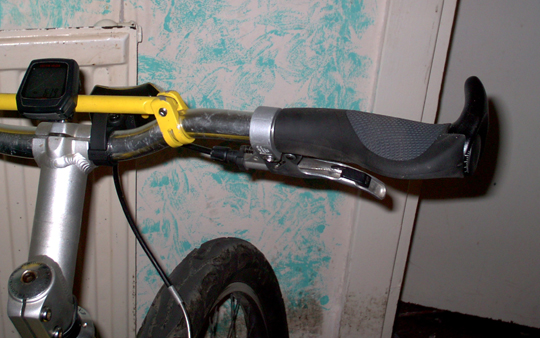

Also check the grips, they totally support your palms and the wee bar-end type things are so comfortable. £30quid mind you!
