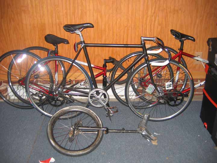

here is my bike 1970’s viner pistoia cicili track bike … and behind mine is my old fuji(now my roomates) and my girlfriends fuji track bike, and in the front is my busted unicycle…:o

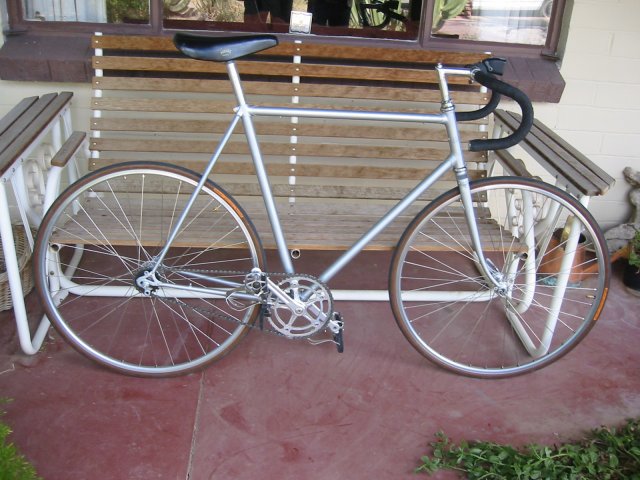

Here’s a link to the bike spudboy mentioned.
