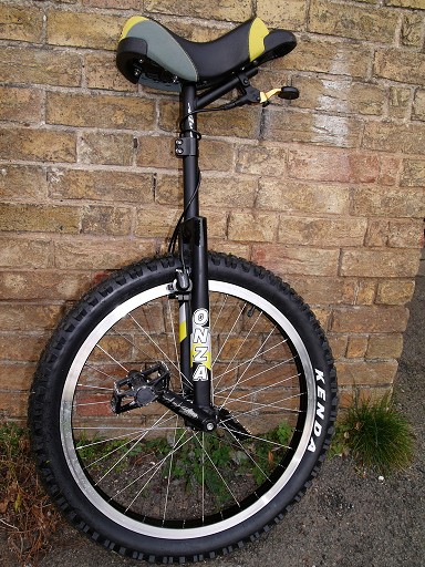

Does anybody use a brake to help freemount??
My 24" Muni has a brake, but as a can barely ride it yet I’m not sure why!! However I am wondering if somehow it could make learning to freemount easier, and if so how?
Anybody useing a brake like this? Actually any feedback on brake’s would be appreciated (forwarned is forarmed as they say).
This is my Muni:
I’ve not heard of people doing it (but then most people don’t have a brake on their learner uni!), but it may help. I used the “wedge a rock/stick/kerb behind the wheel” technique when I was new to freemounting, so perhaps holding the brake on may do a similar thing (lets you step on the pedal harder as you jump up without the wheel shooting backwards). Worth a try - but before long you’ll get used to doing it properly anyway.

Wow that Onza 24 was my first MUni! It is what I learned to freemount on! Yours is a beauty! I had a brake on it too but never used it to freemount. It is funny though because when I was in the Lebanese war tons of fellow soldiers would try to mount it and they all clasped the break for dear life!
