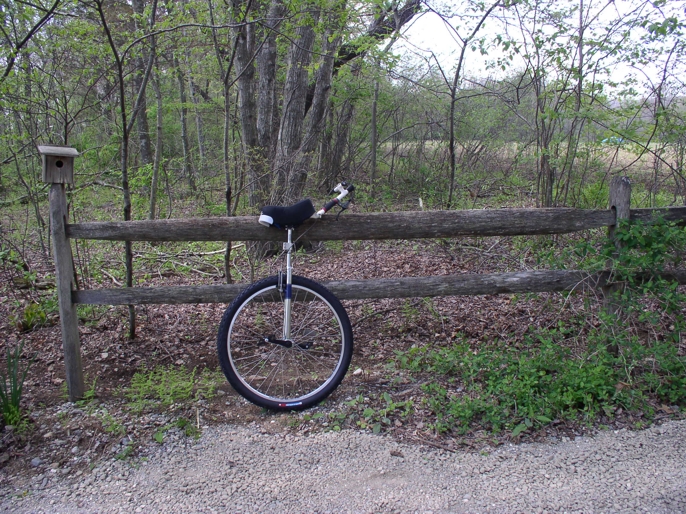

Hello everybody!
Ben Plotkin-Swing and I have been collaborating on an Endurance Racing 29er for the Toronto race at the end of May. It’s not that handsome because we did some parts scrounging. We didn’t make weight our primary consideration to cut down on cost somewhat. Basically our goal was to use a non-Magura brake and to use the GBDS handle to enable normal brake lever action, allow better cyclometer positioning and manipulation, and to allow the use of a uni-mounted headlight to supplement a helmet light.
It turned out to be surprisingly light anyway, and the brake seems to have turned out well. We did a day of final setup and testing here in Connecticut, and now Ben has it back in Boston for more shakedown and to prepare for the race. We’ll see how it holds up!

That sounds interesting, Dave. I want to see more but the galleries seem to be down today. What length cranks is he planning to run?

Au contraire… I’ve not seen the gallery photos, but it looks like a nice black and white colour scheme you’ve got there. Looks good!
What kind of terrain is the race on? Those do look like fearsomely short cranks…

On it now are 125s and he’s been experimenting with 102s and I believe is going to test 110s as well. But I don’t want to give away any race secrets, so I’ll let Ben explain his approach (if he is willing!). :smiley:

The cranks in the picture are 125mm. So far I’ve experimented with 102s and 125s, and I’ve pretty sure at this point that I’ll use the 125s in the race. The difference between the two is really very striking. With 102s, it feels, as I mentioned in another thread, like a Coker. With 125s it feels more like a regular unicycle, except really fast. I know that several people who’ve done this race before are doing it on Cokers, so I’m not to worried that I won’t be able to ride the terrain.
The brake really compliments this unicycle. It’s helpful both for recovering energy you’d otherwise use slowing yourself while going down a hill, and for increasing by quite a bit the amount of steep terrain that can be ridden in control. The cable brake works as well as a Magura so far. We’ll see how it holds up over time.
The handle strikes a good balance between having things you need, and not getting in the way. I really like the twin hand grips for cruising, and they work fine for muscling the wheel around offroad. The option to mount a lighting system on the handle is also great.l Although I don’t have much experience with other lighting systems, my impression is that having a light mounted on your frame combined with a light on your helmet is more effective than that amount of light combined, on your helmet.
Overall, working with Dave to build this uni was a lot of fun, and the result is an amazing ride.

What kind of air seat is shown in the picture?

Dave Stockton built the air seat. It has miyata foam and a 12" innnertube wrapped in duct tape, in a KH cover. It’s firmer than airseats I’ve used in the past, but that actually makes it more comfortable for distance riding because it doesn’t squish around and apply pressure where you don’t want it.
