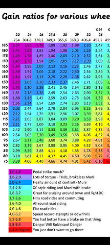

@Setonix @PedalSprell @Wheelou, appologies if this has been posted before. Unicycle gearing Crank Length vs Wheel dia. Its only a guide as leg strength, leg length, fitness, terrain etc all play a part.
Out of interest I match up all my unes on there current set up, crank length vs wheel dia for the types of riding I do. First for road, then for muni and they all came out pretty well bang on.
Very useful if buying new cranks as you can compare the gear ratios of each size. :grinning_face::+1:
Thanks @MadHatchetAndy. For me from 26" and up I prefer 150mm. A healthy amount of control on any surface. And mounting is the same for any wheel, just a bit higher for the 36". Occasionally I change to shorter cranks to get the feel and then decide to go back to 150mm.
@Setonix yes agreed, for muni on the 26/27.5/29ers 150mm is about right for me also, on the road, I prefer to drop to 125mm. One real benifit of 3 hole nimbus cranks, I can just move pedals. Expensive yes but 3 crank settings in one.
On the 24" 125mm muni 114mm road and on the 20" 114mm muni or 100mm road.

Bottom line: Currently, I can‘t just match the total gain ratio for all of my unis and be done. Depending on the wheel size I can, or can‘t ride a certain TGR (for a specific application, such as road riding).
@Wheelou of course it is what feels right for you on that uni and what your doing on it. It always amazes me, how the smallest changes can make a big difference to the way a uni rides. Whether its wheel dia, wheel weight, tyre width and profile or crank length.
