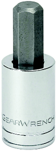

I use the 8mm socket. You can get more leverage
Use the gorilla method. Put a pipe on the hex wrench, and give it a quick turn. If the bolts were torqued up tight, and haven’t loosened during riding, they will be pretty tight. Remember a hand-held L-shaped hex wrench provides a lot less power than a torque wrench with a long handle.
I don’t recommend heat in this application, and “Liquid Wrench” or similar products will be ineffective, IMHO.
(Strokin99 beat me to it. That tool, combined with a long-handled socket wrench or breaker bar, will make short work of it.)
