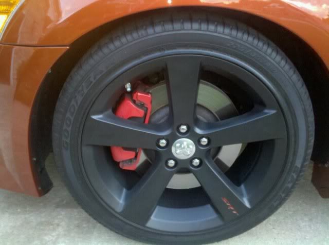

Should stay on fine unless you have a rim brake. People coat their car rims with it and a car rim is exposed to the elements a lot more severe than a uni rim.
Here’s an example of a plasti-dipped rim and an entire car!
