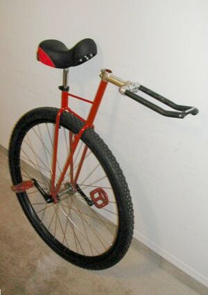

It finally rained in Seattle this weekend, so I was able to finish welding up my first Coker frame project. This is a modified Hunter, adding a vertical front support tube, at the top of which is a bike stem and my regular road handlebars. As you can see, I prefer my bars way out in front. I wasn’t quite sure where to attach the 2 joining tubes, so I put them at different angles to see how it would look. The smaller diameter was all that was neede to provide adequate strength. But next time I’ll try parallel joiners. I used TIG brazing with silicon rod on 4130 tubing.
Anyway, here it is, the paint is still drying…

I rode this coker for a half-hour today, and I really like it. I do prefer a somewhat bent riding position for road, so this fills the bill. While this frame places the bars the most forward I’ve ever tried, on the level and uphills I still had my hands at the front of the bars. On downhills (I went down the long SR-520 hill in Redmond) I tended to move my hands back a bit, but still comfortable within the fore/aft grip range of this bar position.
On my previous version (see John’s pic above), I used an extended stoker stem to mount the bars, which was OK in terms of feel, but not super-rigid. With this V-frame, the feedback from the bars was more direct and instantaneous, and I needed less independent correction input with my arms. I felt I was using my whole body more as a unit to control the wheel. So bottom line is that I’m very pleased with the design and feel of this frame.
I’m already working on the next model, which will have an even wider “V”, so that I can mount the bars directly on top of the front upright tube (we need a name for this new tube), thereby eliminating the bike stem part. I plan to use a shortened recumbent-type straight riser stem that will insert into the front upright tube, using the same seatclamp as with the seatpost on the rear seat tube. So the bars can still be adjusted up & down.
Also thinking of an aluminum frame of this design, to lighten it up more and presumable make it more maneuverable…I would think all these coker frames would benefit from light weight just like bicycle frames.

For the next model, I’m gonna set the spacing between the vertical tubes at 8", measured at the tire top. That should allow me to mount my bars directly on top of the front tube. I’m gonna cut both the front & rear tubes at the same height, with the front carrying a sliding aluminum handlebar clamp. This first model has the upright spacing set at 5" at the tire top.

Here’s the updated V-frame (the “Red Menace”), which has an even more responsive but pleasingly stable ride! Yesterday I cut off the 2 horizontal tubes, and TIG-brazed on longer ones (this time parallel) to extend the V separation to 8", measured at the top of the tire.
