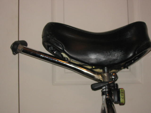

Now that I have actually been riding my Coker, the homemade air saddle is starting to show some signs of wear from striking the pavement. The bumper on the front doesn’t do much good due to the added thickness of the air cushion. I needed to come up with some type of bumper system and decided to add a handle instead .
The problem was having a 30" inseam, I had to ride with the shortest post and didn’t have any way to attach a handle directly to the post. I did not want to mount a handle to the seat base and shorten it’s life, so this was my solution.
I used an old steel handlebar that I had laying out in the shop and after cutting it to the necessary length and angle, I brazed it to the seat post collar. Next, I mounted a “stubby” Profile bar end and “instant handle/bumper” :smiley: :smiley: :smiley:

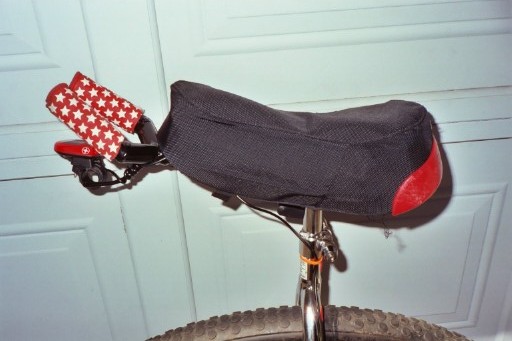

Another option to consider that’s independent of the seat post is the GB Handle. I’ve used mine for a couple hundred miles and have been pretty happy with it. It’s true it mounts to the seat base, but if you use either the gemcrest CF base (light but pricey) or the GB Stiffener Plate (heavy but cheap), you’re not at much risk of shortening the seat life. With the GB handle and plate combo, you’re basically bolting the handle to steel, which provides a super-strong platform for pulling up, pushing down, hopping, etc.
Here’s a picture of my setup:

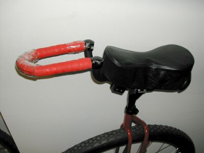

I used a bike seatpost adapter, ran part of a Y-shaped aero bar up to the front of the seat, and clamped-on custom U-shaped tubing made from modified bar ends. The U handle is 10 inches long so I can set my hands forward. The bottom bar section is attached to the seatpost adapter brake tube with a standard seat clamp.

Is the handle doing double duty as the seatpost clamp?
Yes John,
Thank you, that’s the point that I was trying to get across to everybody!!!:smiley: :smiley: I had no other place to mount to handle due to having to lower the seat all the way because of the air saddle.
That’s the beauty of it. If a problem arises, I just buy another cheap seatpost clamp and build another one. I’ll try to post a better picture of it (off the uni) this evening
Now it’s making sense. I was wondering why you had a quick release on it. That’s a clever idea.
Here’s mine. I prefer the hand support way out front. Note the seat clamp which attaches the bar under the seat to the brake post on the seat adapter.

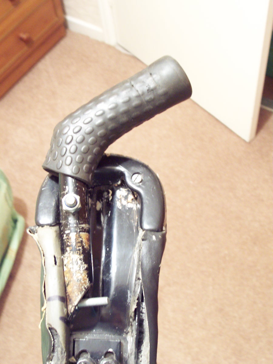

I have just finished converting my viscount saddle on my Pashley MUni into an air seat and added a handle made out of a mountain bike handlebar stem with a handlebar grip over it, although its at an angle it seems OK to use with either hand. The airseat is fantastic, I should have done it ages ago and would certainly recomend it to anyone who hasn’t.

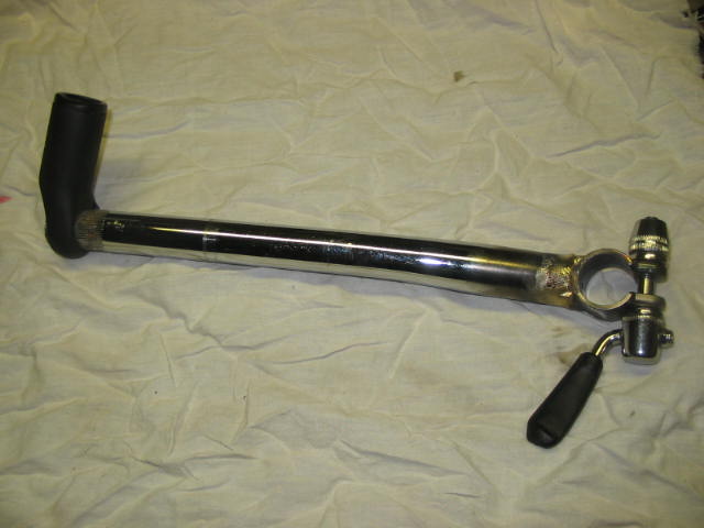

Here’s the handle, detached from the Coker. Upon reinstalling it, I realized the real beauty of it’s simplicity. It can be adjusted to the left or right (off-center) independently of the seat position.
