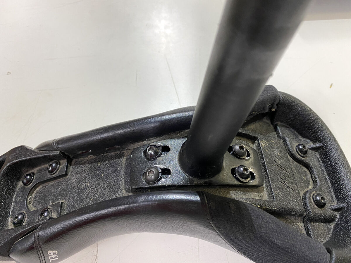

I also raised my saddle incrementally until it felt more “natural” and adjusted the saddle’s fore-aft position all the way forward which “seemed” to help with stability?
This is where it was positioned before I moved it.

If you instinctively grab for the handle, then you are that much closer to riding muni! One of my teenage neighbors learned to ride 100 feet in no time. The uni he learned on was an old Sun with a crappy seat. He rode, from the beginning, with one hand on the saddle. Your saddle is much better! The first time you order anything from UDC, I’d pick up a set of 5mm seat bolts. From the picture, looks like your uni has the stock 4mm ones. Those were, for me, a “weak link” in the setup; they deformed after repeated tightening. You mentioned that the saddle was initially low, then you raised it. That probably meant you didn’t have a very firm grip on the saddle with your thighs, causing the unicycle to pivot left and right, which then caused you to compensate by holding on. I have a wide stature and have never been good at stabilizing the uni with my thighs. I think what happened when you pointed the nose of the saddle upward was: You increased the connection between your inner thighs and the saddle.
