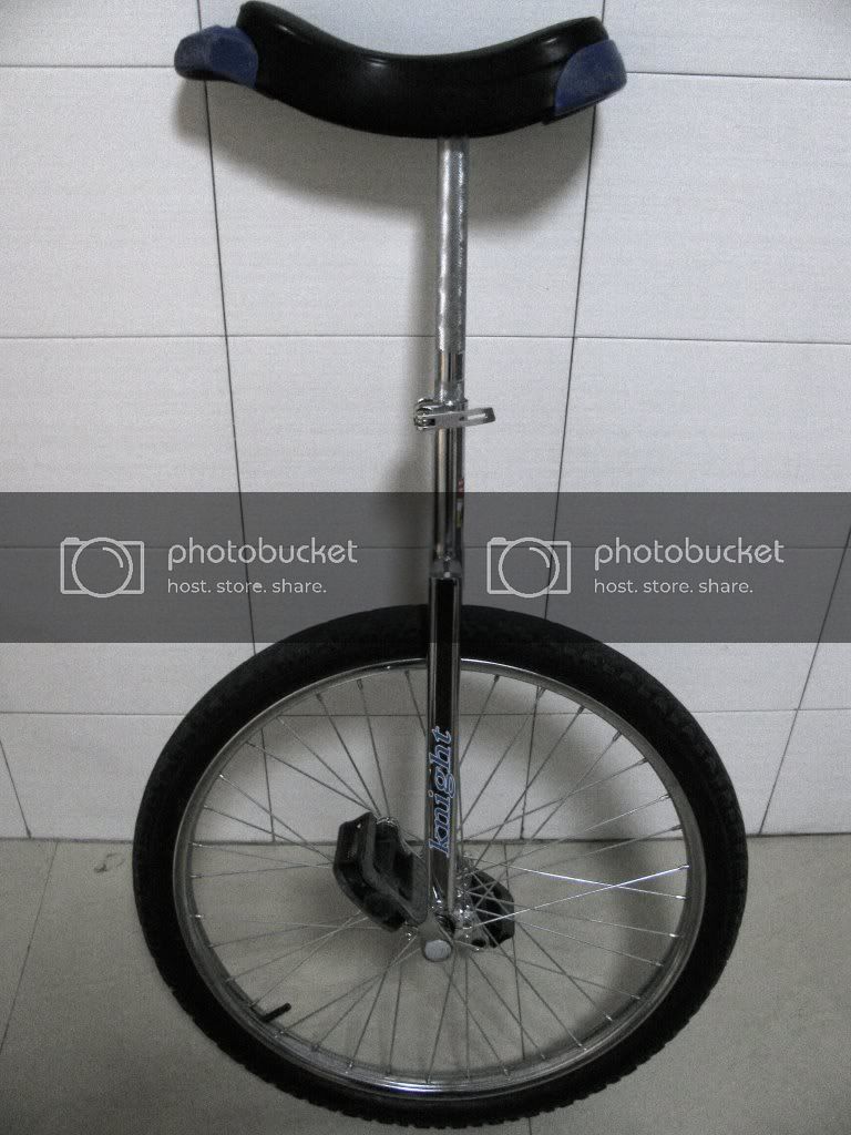

Hi. I am a newbe having just started learning to ride a few months ago at the age of 55, weight of 220 and height of 6’3". I am hooked for sure. Am a Michigander teaching English in Harbin, China where there seem to be very few unicycle riders. My goal is to be the first to ride across the Songhua River when it ices over.
First, can anyone identify the unicycle I am using in the photos. I think it came from Taiwan or southern china. It is the only one I could find in Harbin and has held up really well considering my current ineptitude.
Second, the seatpost seems a bit short so I could get a local to weld a bit of something in there to lengthen it. When I ride my legs get exhausted at 50 meters (I know, not sitting down, all my weight on my feet) but when I do sit down I feel like my legs are too bent to have any power. It feels like the seat should be an inch or so higher. My question: do you have more or less control when you ride with the seat lower? Or, what is the optimum seat height?

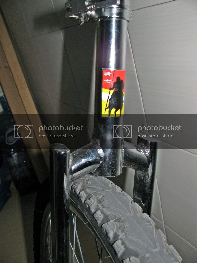

It’s a standard local make that probably got some inspiration from the major unicycle makers judging from the textured seatpost and handle. The chinese on the post reads ‘Rider’ which could probably translate to Knight as well (Knight rider, har har).
To your other question - more control with your legs outstretched (ie higher post). Optimally, your legs should be slightly bent. It’s really a personal preference I realise. I’m very used to an almost 45 degree angle on smaller wheels but I know of people who like a 10 degree bend. As long as your weight is on the seat and you feel comfortable, don’t worry so much about what’s ‘correct’.

I didn’t try one but “knight” is the newest brand and with the best quality in China possibly. Your unicycle is the beginner model called “discovery”. There are an Aluminium unicycle (20"/24") and a 700c unicycle of the same brand sold there. Very inexpensive and only <600 RMB (~<90 USD). There are also other models according to someone (19 models. including 33", 36" 45", carbon, monocycle. I really don’t know whether they are sold anywhere in the world.)

By the way, a higher seat will definitely force you to put your weight on the seat and save your legs. Once, I tried to set the seat half inch higher than my legs. It forces me to put all my weight on the seat.

One thing to note; generally the notch in the frame where the seat post goes in is oriented towards the back of the unicycle; you have it oriented towards the front on yours. That in itself is not a problem, but you should make sure that your seat hasn’t gotten twisted around, because what does matter is which side the pedals are on. Make sure your right pedal is on the right side, otherwise the pedals will unscrew and damage your cranks.

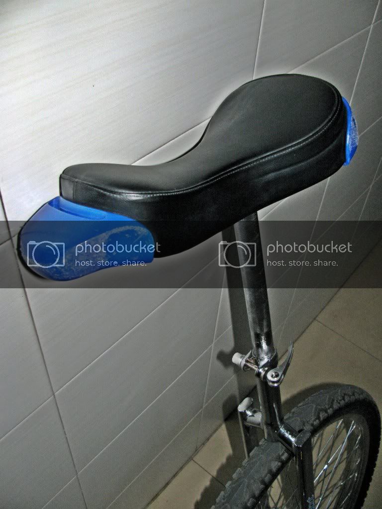

Your unicycle looks like it has the Miyata saddle (now made in China), which were the best you could get before KH came along. For best results on an icy river crossing, consider a larger wheel. It’ll roll over the bumps better. In the absence of snow, a large expanse of ice is probably like riding on flat rock. Mostly smooth, but any bumps will be very unforgiving.
If you can feel your seat being too low, you probably need a lot of inches to bring it up to a proper height for casual riding. If you’re 6’-3", it looks like you might need another 6" so don’t skimp on the seatpost mod. You can always cut some off. For best results on a custom modification, have them cut the post off at the plate, and add tubing at the top. This keeps you from having to worry about exact tubing size. Just make sure they reattach the seat plate with a really good weld. Or they can use a larger piece of tubing to sleeve over the existing tubing, leaving the “proper” part for attaching to the rest of the cycle.
For regular riding on flat surfaces, a general rule of thumb is to have your leg almost all the way straight when your heel is on the pedal. This gives you a light bend with the balls of your feet on the pedals, which is the normal position for riding. That kind of seat height is good for general riding, Freestyle and distance riding, but you’ll want a lower (or much lower) seat for some other types of riding, such as rough terrain, Trials, etc.

By the way, the textured seat handle isnt texture. Im a beginner.

When someone mentioned texture, I think they were talking about your seat post. The texture is very good for keeping the seat from twisting, especially with a quick-release clamp. The texture on your seat handle tells us you ride outdoors. :slight_smile:

By the way, I had the post extended by a welder today and it really gives me more control.
