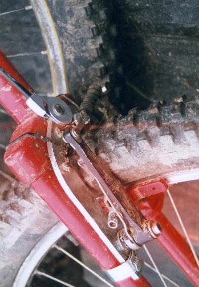

Lars took a picture of my uni with a DMR V-dapter @
I don’t think they’ll work that well with 3.0 inch tyres though
(the tyre fitted was a Tioga 26x2.3 DH).

I’ve never seen a stock booster that works with a 3" tire. This one surely
won’t.
—Nathan
