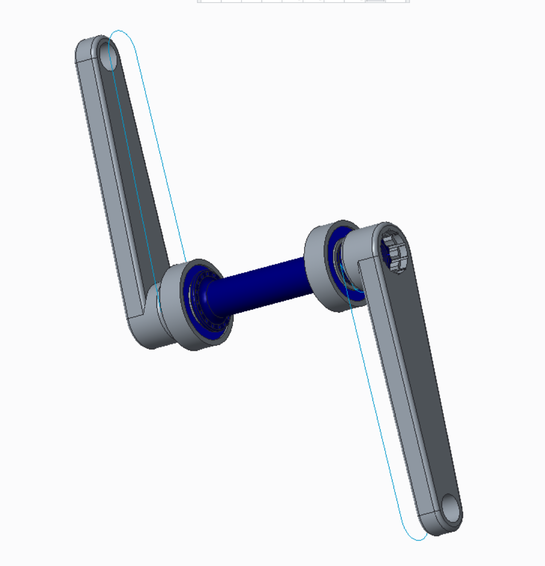

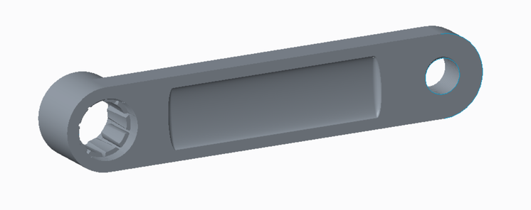

So far I have just designed a pair of ISIS standard cranks with French threaded pedals (M14x1.25 - I can’t stand English measurements yet). These are based off of the ISIS drawings online- with a few liberties added as the radius dimensions for one or two edges weren’t very specific. As I get more information on tolerancing and other important topics these will be incorporated into the design.
This is purely an exercise in fitment design-since I haven’t been through strength of materials or any of that jazz It’s all about the CAD and the fit.

Looks like you already probably know this from the mechanical side of things, but you want to avoid any sharp corners in your design, not only for stress purposes, but because it’s expensive and difficult to manufacture sharp edges. This is especially relevant in something slotted. In the real world, you want to fillet most edges, like the ones around the outside edge of the crank.
Good point! I had meant to round the edges of the first piece and it slipped my mind. Wouldn’t want anyone slicing their leg open on a knifelike aluminum crank! Do you mean Wall E as in the robot?

The next piece! I’m having some trouble with the interface between the cranks and the hub, it seems that the taper for the cranks starts too early. I’m basing the hub roughly off of the mad4one 1 piece CNC milled hubs, though I may widen the center a bit in the future.
Alrighty, Ive got preliminary parts for the bearings, hub, crank and Rim now. I went for a drilled out rim for theoretical weight savings and stuck with the ISIS drive cranks. I figured out where I was going wrong with the hub/crank mating, and it was just drawing error. By this point hopefully you can see where the concept is headed.
