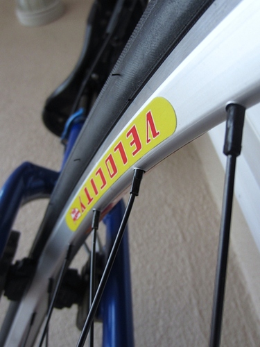

I was assuming that I could mount a 40mm wide tire on a 24mm wide rim, no problem, even though a popular sizing chart says that’s too large of a tire for that rim size, even if that was the inside width! They do say that many people go wider or narrower than what the chart specifies, but the rim width specs I’ve been seeing reflect the outside width. The chart specifies inside rim diameter is used for sizing. If true, than the Velocity Dyad, which is 24mm outside width, would be closer to 19-20mm inside width. So according to the chart, the widest tire suggested would only be 25-32mm. That just doesn’t seem right. There are wider 700c rims, but all are disc-only rims, which I don’t want, or too heavy for the setup I prefer.

You’re not reading the chart properly - according to that a 40mm tyre is actually too narrow for a 24mm internal rim! It actually suggests that a 40mm tyre is fine on a 19, 21 or 23mm internal width rim - a 24mm external rim will be towards the wide end of that range.

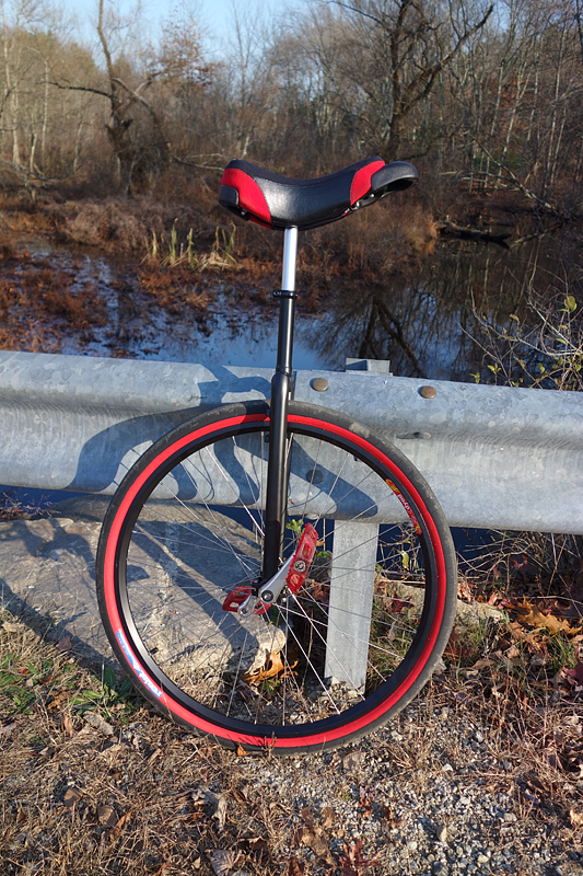

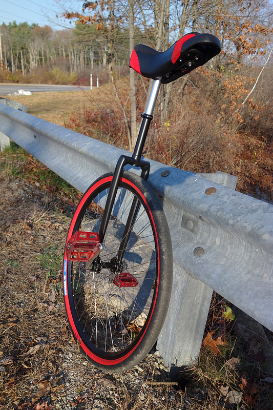

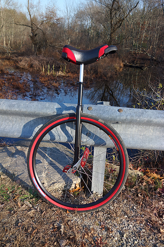

Yep, I’m using a Resist Nomad 700x45 on a Velocity Dyad. I think the tire suits the rim well.
I’ve been looking everywhere for road tires in that size range, but never saw that one! It seems to be VERY reasonably priced too! Do you know the total weight of your uni? Sure looks light! And what kind of riding do you use it for most, distance, speed, climbing, or a mix of all that?

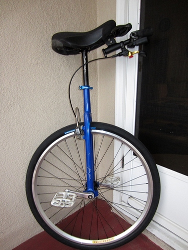

Thanks for the tip! I just ordered the Dyad and Resist Nomad 700 x 45! I got the all-black tire since they were out of the one tan sidewall. I’m looking forward to getting this wheel built and putting it to the test! :smiley:
My tire measures 43mm wide on the dyad and weighs about 540g. The whole uni weighs 11lbs with a steel Qu-Ax frame. Your KH frame should drop 1lb or so off the total weight.
I built it for riding around the neighborhood, quick trips to the store; mostly short rides where I’ll give up some of the speed and comfort of the 36" for a smaller footprint. The 114mm cranks spin quickly but give plenty of control for that sort of riding and are even useable for brief off-road sections.

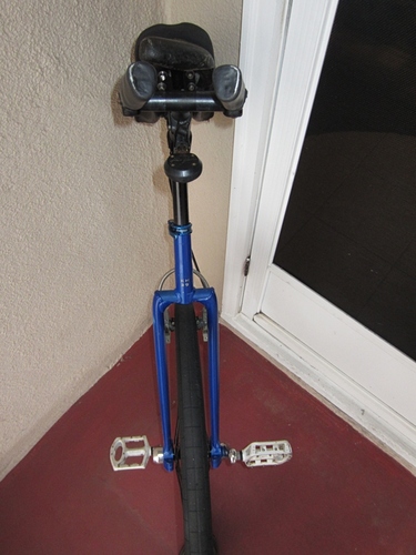

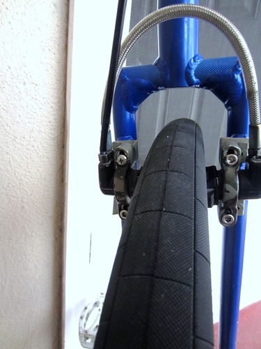

Just got back from my LBS and they did a fantastic wheelbuild! While I was there, I used my Scott Wallis Maggie extenders - which were originally used to allow the brake to fit the 65mm wide LM rim - and simply reversed them to bring the brake pads close enough for the new 24mm wide Velocity rim. Worked like a charm, even though the crossover is huge now, lol!

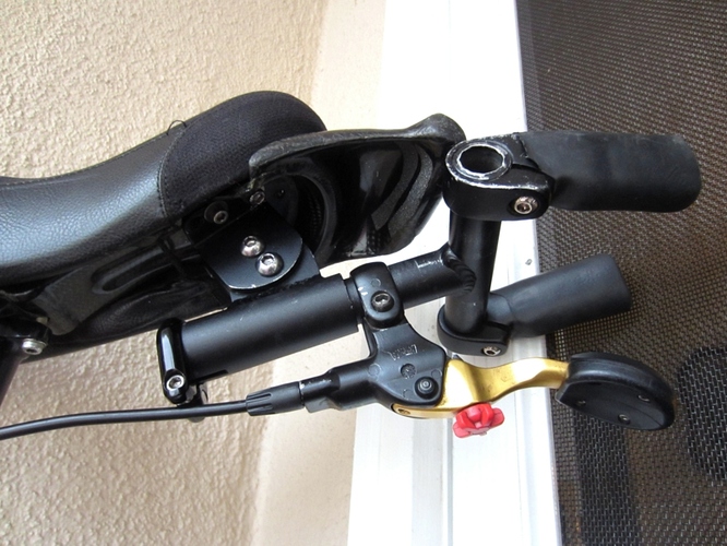

I also modified by KH T-handle to fit my SW CF base, by drilling two new holes into the brackets, so it would line up with the threaded inserts in the base, where the death grip also fits. Now I have both DG and T-handle.
Total weight of my new 29er climbing machine, 11.6 pounds! Can’t wait to take her out for the first climb! :smiley:
