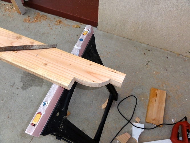

Thanks for that info John. I won’t be going on top to ride, walk or any of that. (Too a scared! :o) Today I decided to end notch the top boards for a more secure fit and easier attachment. Getting the notches straight and just the right size was a challenge! Then more painting.
Next task will be to put cross beams between the horizontal joists, every 24" (which is width of corrugated panels) then finally install the panels. It’s really looking good so far!
