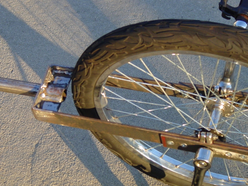

Here is a pic of the 3 wheeler that I built last fall (no pun intended) I departed from the usual design by using a 5in idler as the center wheel.
I found that using high pressure tires reduced slip with the least amount of rolling friction. I have Kenda Qwest 100psi tires on it.
My frame is made out of 1-1/2"x3/16 flat strap steel.
I have painted it yellow since I took this pic.
Al :O)

Al Lieffring, do you have a gallery? I’d like to see some close up pics of how you attached the top and bottom wheels to the frame. Did you use bearing holders? The bottom wheel is a regular 20" bike wheel right? I bet it looks great with a yellow frame!

At the upper wheel I used main cap holders. Because I didn’t think the dinky 6mm bolts could take the load I bolted a bracket over it to hold the upper and lower frame together. I have oval slots for the center axle and at the bottom dropout I have a backwards tensioner. Screws to push the axle up instead of pulling like a chain tensioner. The pressure needed to keep the tires from slipping tend to spread the wheels apart.
